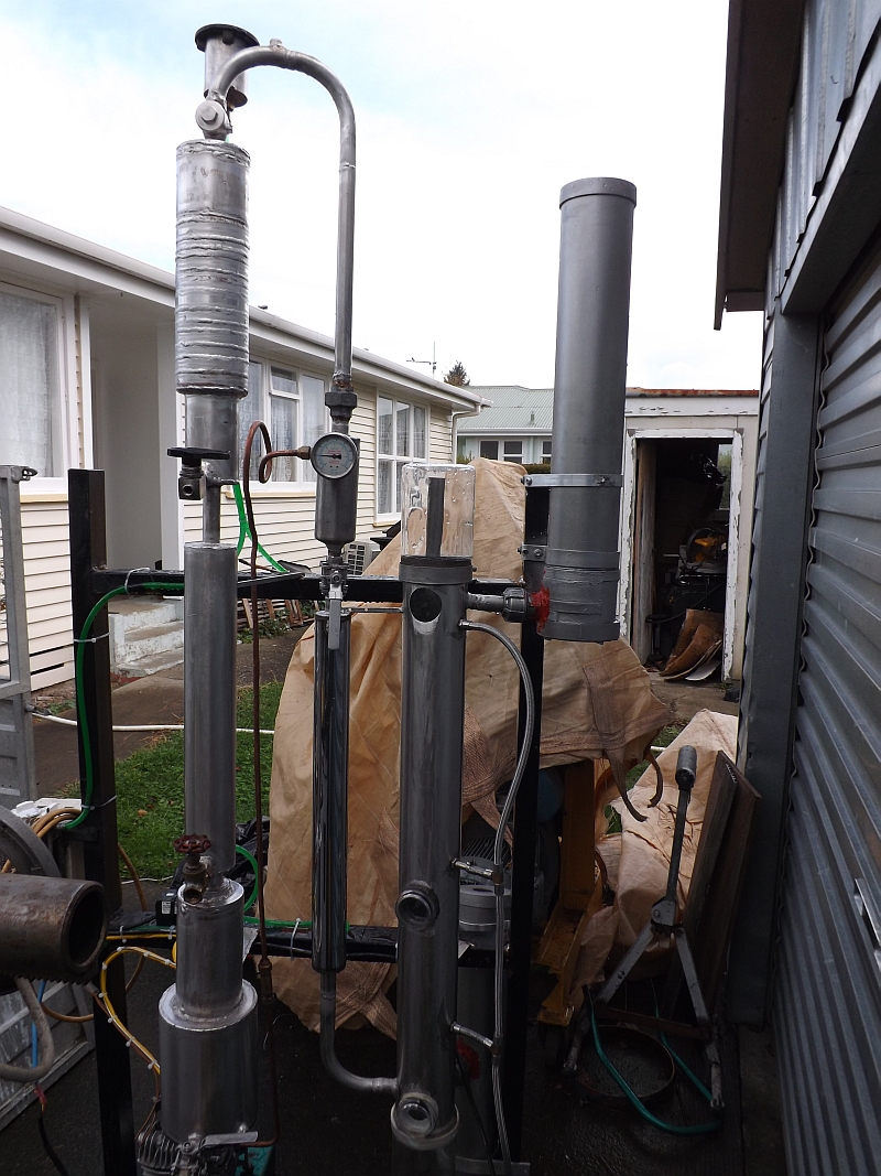

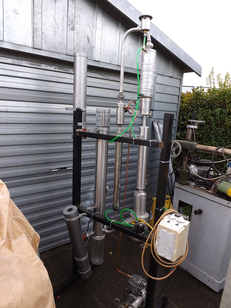

here are some pics of my Distillation tower and Filter tower. I have a Hydrocarbon take off point on the Catalyst vessel, which should give the heaviest product. The connecting pipe will enter the bottom container of the Distillation tower and there is an element under that to take the bottom container to 220 DegC. So Diesel weight Hydracarbons should be able to be drained from that tanks tap. The Gasses that continue then enter the next chamber above. Another Element is to be fitted to maintain that Chamber at Temperature and remaining Gasses then flow up to the top chamber, which is water cooled. I will be able to control that ones temp with a small refrigeration unit and have the lightest fractions available at that take off point. From there, remaining Gasses run through yet another water cooled heat exchanger and down to the bottom of the scrubbing Tower. At the very bottom, the gas enters a bubbler and then rises up through the Tower, where a fine spray of Sodium Hydroxide is injected into the Tower at three different points. That Gasses feed through the Spray and are scrubbed of acids such as HCL, Cyanide, Chlorine etc etc. After the Scrubbing, they enter the Final unit which is the Molecular Filter, to ensure all final Gas output is totally cleaned. the Gas will then run from that to two possible flare points. one will be a simple Flare to Atmosphere, the other being a Burner at the Retort to aid in heating the Plastic.

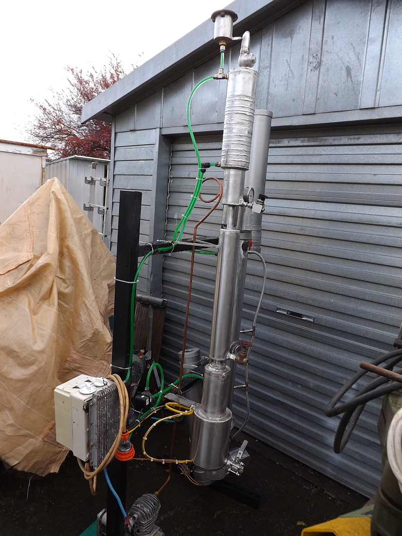

So looking at the 3rd pic of the Towers, the one that you can see the dial gauge in the view (and the little glass windows), the tower on the left is the Distilling tower with three take off points.
At the very top of that tower, where the SST tube comes off the top, there is a SST non-return Valve. I need to move it to a different position further along. As you follow that pipe along, you will see the heat exchanger and immediately below that is a Ball Valve that I currently use to isolate the second part of the unit while the first part is vacuumed down. That Valve is what i want to replace with the Non-return and make the pressure change automatic instead of me manually watching the Gauge and then opening the Valve.
The pipe then continues on to enter the bottom of the scrubber with the glass jars at top and bottom.
The Glass Jars and the little viewing ports are ordinary Glass, but are only temporary. I want to view what is going on in there in regards to the spray and the little glass ports are removable to allow access to the internals for things like changing the water jets and i want to test the Ph of the liquid and take gas samples at those three different points so I can work out how effective the idea works and if changes are needed. Everything is cold at this point and under no pressure. It is just the water/hydroxide mix spraying down and cold dry gas rising. Then the viewing ports and jars will be removed and replaced with SST caps.
The SST braided hose on the right of that tower is the 3 injector points with spray nozzles on the inside. The pump is a Magnetically coupled Chemical pump and you actually can't see it very well if at all.
There is a slanted container at the bottom of the scrubber around the back. That is a water/oil separator and the water mix recycles while any possible oil, which i doubt there will be any, will accumulate and be captivated at the top of that container for removal.
The molecular filter is two stages. First being Zeolite, which is very good and efficient at removing many impurities and chlorine. Although all that should have been removed in the scrubber, it is just secondary. The Zeolite is acidic and the second stage is alkaline. I haven't decided just what, but probably a Calcium type product. I am still looking for what I want and I want it in granular form, not powder, so as the gas can flow through it.

One part of the distillation tower has many concentric welds. Is this sieve trays or what are those for?

Good spotting on the concentric welds. Top secret stuff that is. Haha, na actually it is a scrap piece of SST that was used as a practice by a student learning to TIG weld. Like most of us, Money is no issue..... because we don't have any. All the SST has come from scrap. All the fittings are things I have gathered and horded over the years. Hence why some Valves currently don't match. Eventually I can change small components out and make it more professional looking. The costs so far has been things like Welding consumables, grinding/cutting discs, insulation and the digital temp controller.

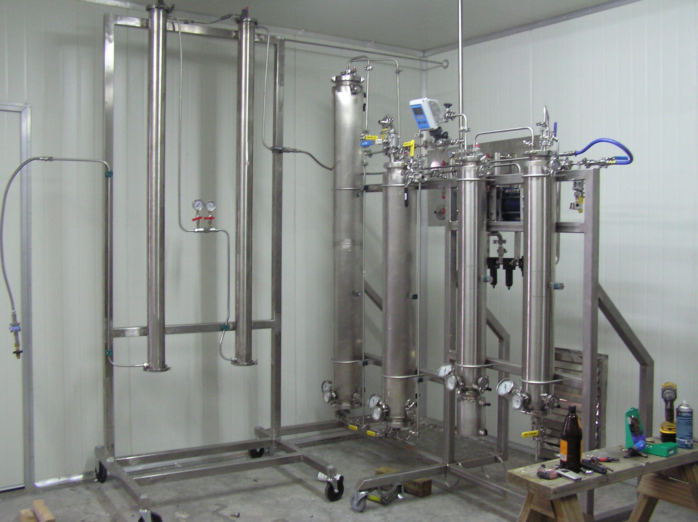

These pics are for the benefit of Excalibur from a PM discussion we were having. But thought others might be interested in seeing what i made when someone else was paying the Bill and Budget was not so much an issue. Related to extracting Oil, but this is extracting Lipid Oil rich in Omega 3. This Machine does have some similar components. At the Left of the Pic, there is the Molecular filters. The first tube is full of activated Zeolite and the second is full of Activated Carbon. The rest of the system uses the Gas as a Super Critical Solvent. It is heated under pressure so as it remains a liquid and that breaks the Cell wall of and releases the oil. The Gas is boiled off from the product and repressurised back to a liquid to go back through the process in a continual cycle. The oil is taken from the bottom of the very right Tower.

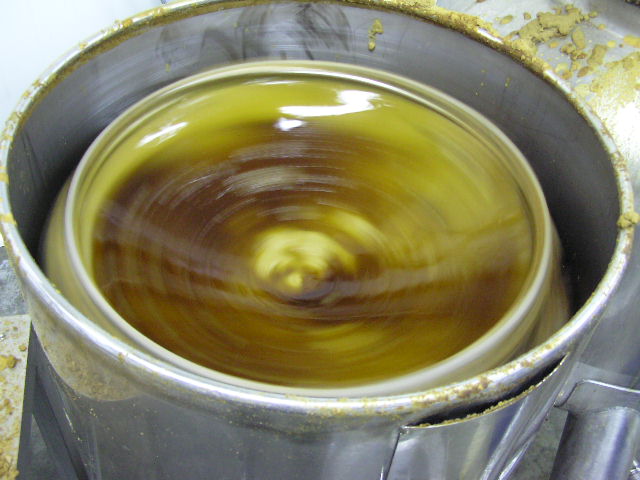

The second Picture is of a big centrifuge I designed and Built. It takes 100Kg of Wet product and spins the Oil and Solvent out of the mix. This is for a different oil removal process. The Drum spins at a few thousand RPM and generates many thousands of G's, placing a force on the liquid that would take a hydraulic press of several hundred ton to replicate.
