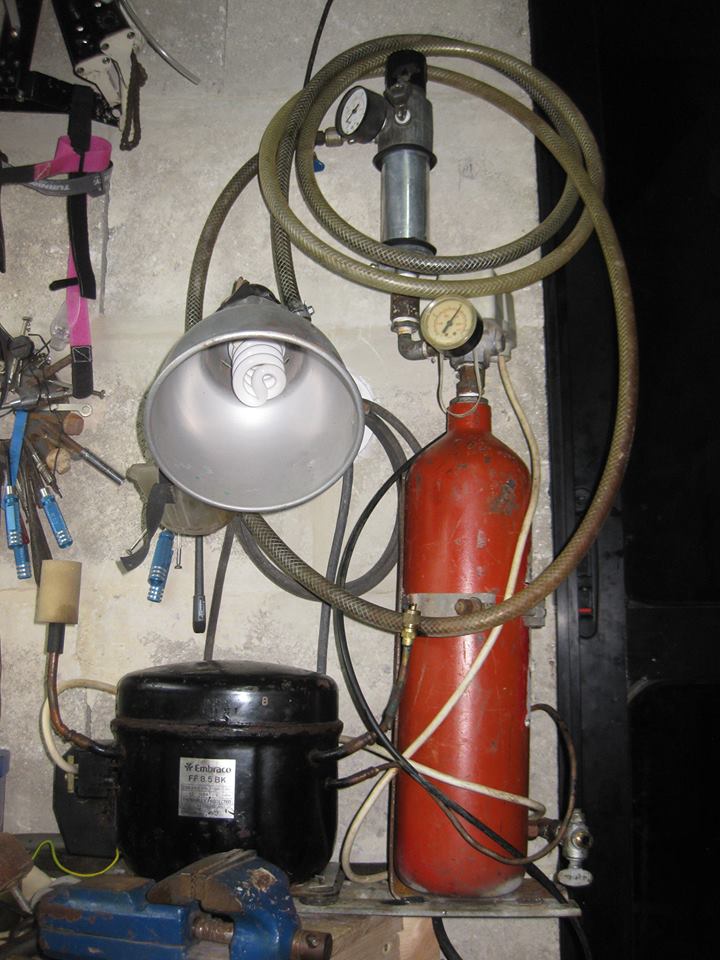

air compresor and siphon oil burner
Siphon Oil burner - YouTube
this is the link of siphon oil burner working with car waste oil it is not perfect but no smell at all.it this video l was using about 12 psi.l use fridge compresor (photo) and small bottle of air and works relax.my nozzle is 0.6mm l try it with 1mm but use alot of air over 50 psiAttached Files
Thanks for video and picture. It looks good. Am hoping adapting it to your reactor goes well. I think that if you can get the reactor temperature up to target with ease, then maintaining the temperature will be relatively easy. I liken it to a pot of water on the stove. High power would be used to bring it to boil but once there, a lower setting is selected to keep it simmering.Originally posted by jonathan View Postthis is the link of siphon oil burner working with car waste oil it is not perfect but no smell at all.it this video l was using about 12 psi.l use fridge compresor (photo) and small bottle of air and works relax.my nozzle is 0.6mm l try it with 1mm but use alot of air over 50 psi
I fitted a thermocouple to the burner-pipe-to-retort and in testing it was delivering between 500*C and 800*C for most of the time. It gave a very good insight as to how hard the burner was working at any stage so I highly recommend.
burner
thanks excalibur its works well very yellow bright sometimes turns little white after time. l run it over 20 minutes the flame keep going and doesnt go up and down. my proplem was the nozzle its not perfect.lmeant it is not in the centre. l will do 3 screws 120% more perfect
