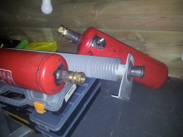

    i have been preparing and reading for a while, read the 1st 6 pages of the forum from a to z and randomly a lot as well; cant find what to use to seal the threads; teflon tape loctite 5770?? thanks
    got my bubbler, 1st condenser and coolpipe ready, i attached a pic

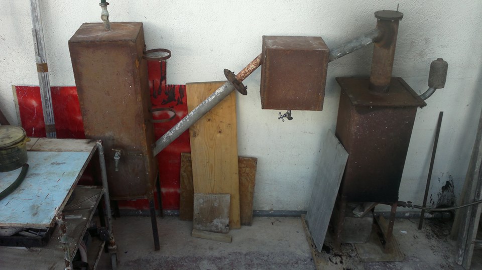

        • pyrolysis photos
          my pyrolysis photos

              Thanks for the photo. You've put in a lot of work!
              Insulation would greatly improve the efficiency.
              Temperature monitoring is the key. The retort really needs a thermocouple. At a pinch, for the reflux you could use an old oven gauge from a coal range which are simple bimetallic. Other places where temps are much lower, cheap digital gauges are useful.

                thanks excalibur l have digital tempreture controller but l have proplem with sensor it leaks gas l will upload pics so for my pyrolysis system did you think my proplem was from heat? reflux tower was so hot after 1 hour but the top of reflux and pipe that exit to first condensor was normal l leave my hand on it so if you can help me did l want to have pipe from top reflux to first condensor to hot let say 260 degrees celsius? thanks
                • jonathan
                  I think you should:
                  1/. check there is no blockage
                  2/. Remedy the sensor leak
                  3/. Fit a thermocouple to reflux
                  4/. Ensure bubbler is operational after last condenser
                  5/. Waste oil as feedstock while you diagnose
                  Start the heat. Look for bubbles @bubbler. Any water in the oil will turn to steam and bubble around 100*C and could be vigorous. Then a period of calm in bubbler before gases come. Aim for 400*C in retort, 300*C in reflux. Bubbles indicate gas flow. Heat in reflux and pipework indicate gas flow.
                  Bring heat up slow and steady. Avoid rapid increases in temperature.
                  The figures given are approximate so tweak from there.
                  http://diydiesel.blogspot.co.nz/

                            thanks beyond biodiesel its a good idea for the sensor if you have a photo l will understand you more.l open my retort today l find that lot of plastic was same as l put them so my proplem was not heating enough.the plastic that is already melting can l heat it agian or l have to remove it? thanks
                            • Originally posted by jonathan View Post
                              Reheat is OK
                              • retort problem
                                thanks excalibur when l have time l do insulation and check temretures l will upload my result thanks alot
