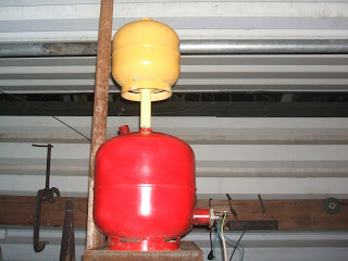

I have also used cyclone separators for separating animal fat and water from my WVO stream when pumping out a storage tank. While it is not super efficient, it definitely works, and it works at high velocity, so that when I pumped from a storage tank, my transfer pump pumped the WVO through a cyclone separator on its way to my mobile storage tank. It worked great.
Originally posted by imakebiodiesel
I am still developing my WMO distillation system, so it is not at all a regular process that I run at this time; however, I have run 10 to 20 batches and have not seen the need to clean out anything yet. There is a buildup of coke on the inside walls of my retort, which I expect to have to scrape off one of these days. The pipe work has a thin coat on it, but it has not posed a threat to plugging yet.
