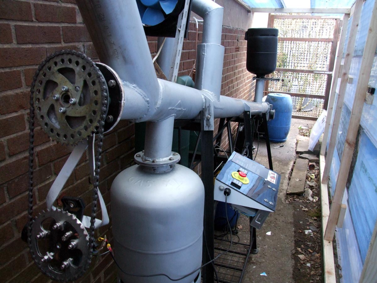

I tried the new auger reactor machine today and it worked... it needs a few mods... one of the easiest mods is altering the PID control settings but there is too many things for my confused mind to cope with....
The basic problem is the oil burner control, it refires the burner too frequently... so I ended up manually altering it so that it had a 100 degrees of cooling before firing again....
Does anyone understand the basics, I keep reading about P, I and D and hysteresis and all the other control factors... how do I make it less responsive?
I think I am using REX C100 PIDs but the manuals vary depending on whether you have a real one or a copy... I'm pretty sure mine are copies...
anyhoo, with competent adjustment it should do the job... but today I had to resort to, manually turning the set points up and down everytime the correct temp was reached...

Plastic is injected all the time using augers and heated screws....
You still have to get the plastic in the auger....
My new machine can be continuously fed with shredded plastic...
But, it does need a new 'thing' adding... I have blisters from yesterdays test run... we need an auger to feed the auger otherwise the plastic stays in the hopper.....
Back to the PID controller.... its a really sophisticated one... from china... so the manual is as clear as polystyrene fuel.... it gives you the name of the various parameters... not much use to me....
The PID running the cooling fan is great, but the fan doesnt mind going on and off frequently....
