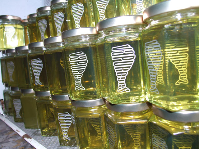

              • Consistent Fuel
                I think we have finally cracked it... fast warm up using the flu pipe waste heat and limiting the reflux to 190 degrees C... The first 20 litres of proper fuel!
                Still havent caught a single drop of fuel in my second and third condensers...
                Anyone tried their high grade stuff in a 2-stroke engine?
