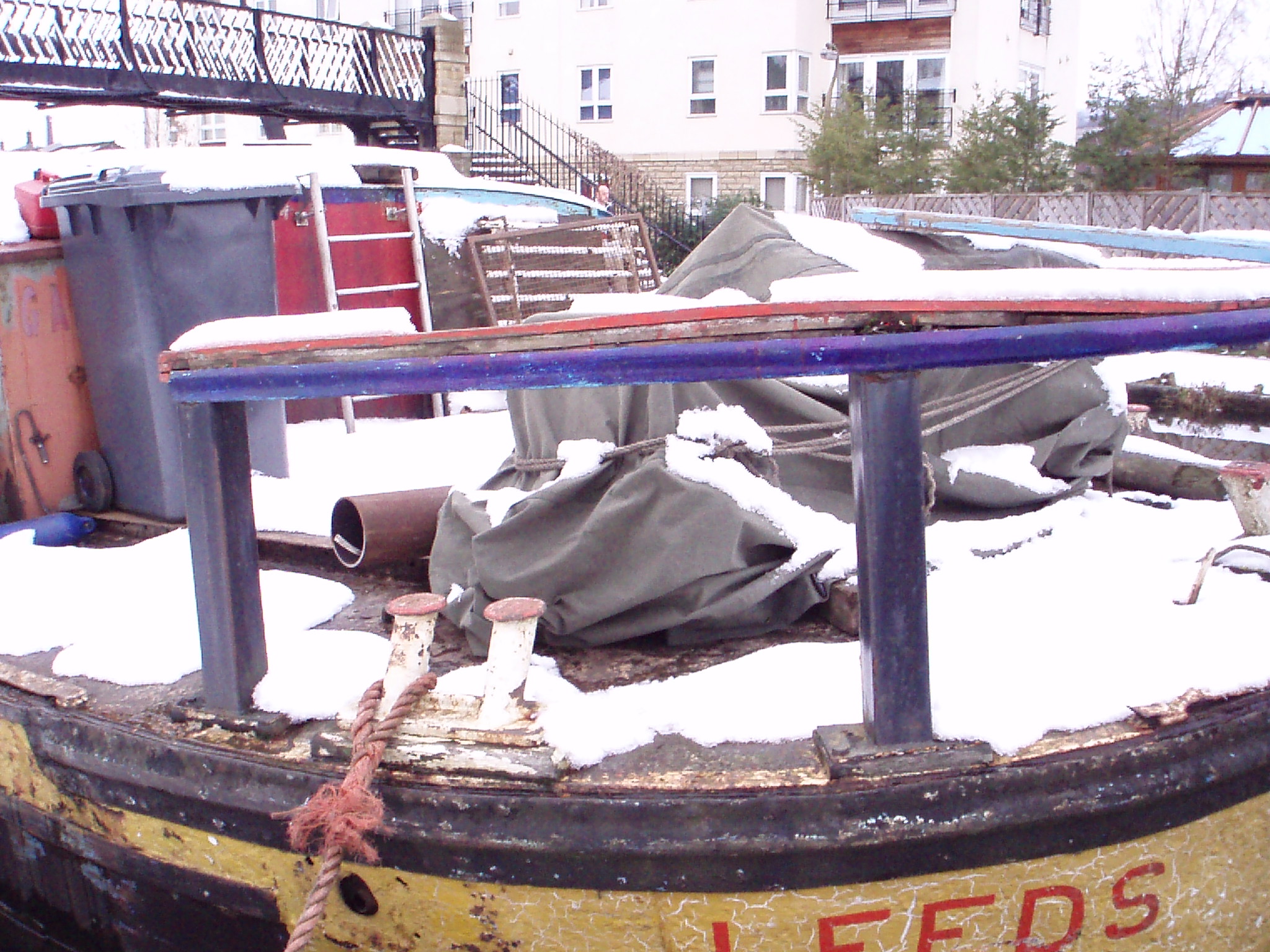

if ive got it right heres some photos of how far ive got with my plant, to be honest ive not done anything for a while lots to do on the boat.as you can see from middle photo im iced in at the moment
after recent discussions on here i want to put a reflux vessal between the retort and the codensors any ideas on this how big etc would be appreciated
ive got insulation to go around the retort and im making a fire brick surround for the burner below

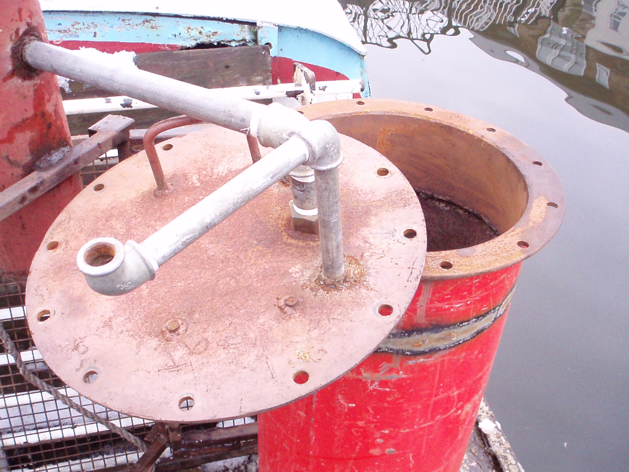

i have flat copper and brass washers for flange, this was just because of availability/exspense of getting a grooved lid machined. my lid and neck came from a scrap yard.

kris 8, thanks for posting up the pics. I see you have used thread tape on the pipework from the retort. This won't last well at all. The 400.C+ is well above what that tape can withstand. The joints will leak, meaning that gas and condensate will escape creating a fire/explosion risk.Originally posted by kris 8 View Posthello all

I'm told that anti-seize works better for threaded joints at these temperatures. I'm about to test it on my turk-retort.
I would suggest furnace cement. I've been using it for awhile and it holds up great.Originally posted by Excalibur View Postkris 8, thanks for posting up the pics. I see you have used thread tape on the pipework from the retort. This won't last well at all. The 400.C+ is well above what that tape can withstand. The joints will leak, meaning that gas and condensate will escape creating a fire/explosion risk.
