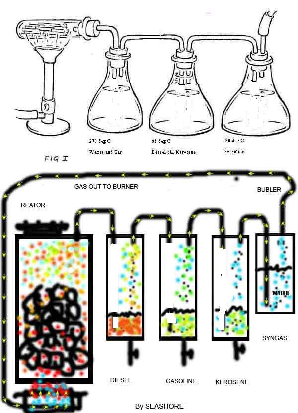

          • Correction on the drawings
            I made a correction to the drawing "Pyro" that I belive is OK and can be used in all kind of reactors...
            Please study my image and tell me if its OK for sure...
            And I'd like to have some more informations about catalyst...
            In post above TUTANKA said "As catalist you can use powder of sodium" and "Please don't use sodium with water.. very dangerous"
            I didnt get it ... isn't it the same thing!!!
            Explain it bether... how to use it...

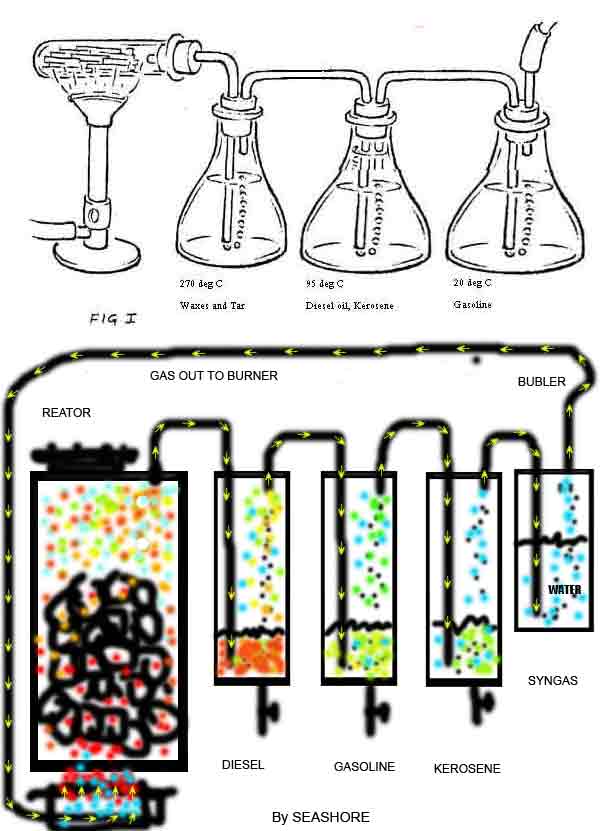

              • New Drawings Of The Reactor
                I made a new Draw of the reactor as I understand how the process should be...
                Please take a look at it and comment about it...

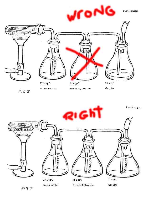

                • Seashore. I attached a pic on how it should be.
                  The incoming tubes should not be immersed in the condensed liquid, this will only create unwanted pressure. The incoming and the outgoing tubes should be at equal length and way above the liquid. The incoming tube should be immersed in water only at the last step - the bubbler.
                  • Originally posted by seashore View Post
                    I didnt mean it ... isant it the same thing!!!
                    Others catalysts... methods...
                    I saw a video where the "inventor" turns plastic into fuel and he claims to use a catalyst, a white powder, that makes
                    it happens faster and ease... but as a secret, he dont say the name of the white powder...
                    Do someone have any knowledge of what that "white powder" could be...
                    So, I beleive that "catalyst" is the second topic we should discuss about here...
                    Lets talkabout catalist...
                    Tankyou all!!!
                    • Originally posted by Jetijs View Post
                      • To Jetijs's
                        I saw the video YouTube - Easy way to make your own diesel from plastic waste
                        from YOUTUBE user "Meskalitto" that I belive are you or your partner...
                        If its right, Do you have any other videos of the reactor to show...
                        I saw it 100 times and Im curious about what kind of "fuel" came out the others cylinders...
                        The water in the bubler retain some kind of oils too...
                        What do you do with the water when you finish the process, discard or keep to refine the oils in it...
                        How do you "clean" and use the oils you process...
                        You said:
                        "The incoming tubes should not be immersed in the condensed liquid, this will only create unwanted pressure. The incoming and the outgoing tubes should be at equal length and way above the liquid. The incoming tube should be immersed in water only at the last step - the bubbler"
                        Sniffing around google, I learned that is important that the tube to be imersed in the liquid, because it cleans the gas, maintain the pressure and temperature of the process at all, what cracks better the oils to next stages, producing light oils...
                        Some process using catalyst as "calcium carbonate CaCO3" mixed in the water of the first "stage/boiler" after the reactor, used the same way of a bubler, makes the producion of better oils and less parafin...
                        or as the oil cames from reactor, pass through the hot carbonated water, cracks the oil to make light oils and gas, where some heavy oils as "diesel" are condensed, and the light oils and gases goes to the second stage/boiler, and so on...
                        The design I made, I used some colors as the oils/gas are produced...
                        So, you have the reactor working, and able to make a test to the process I described here, and post the results...
                        And please, make a film or photos to post too.
                        Thanks.
