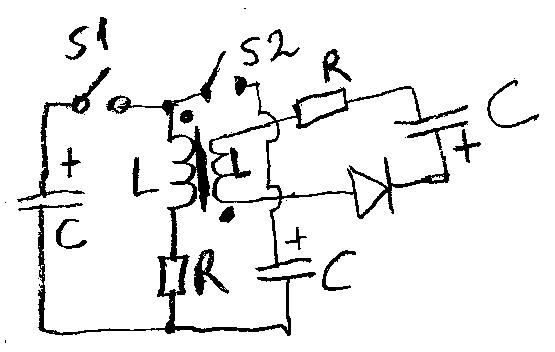

        Let's start with a schematic drawing I made as per your post:
        The senario is this. Suppose you have a capacitor of certain amount of energy, a transformer, and 2 extra empty capacitors of the same value. You now send pulses to the transformer under no load and recover the electricity at say 70%. Repeat the senario, but now load the transformer with an empty cap. If you can still recover 70%(not counting the load), would that validate my equation?
        See my attachment. On the left you see the capacitor C, charged up with some energy in advance. The two switches are needed to start the process for a duration of a fraction of the L/R time as the ON time for charging up the coil and the empty capacitor (also has C value) then both switches are off, (S2 is needed to prevent this latter C from discharging via the transformer primary coil, i.e prevent to form a parallel LC circuit), and then the collapsing field charges up the third empty capacitor, (it also has C value). Dots at the ends of the coils represent phasing. R means coil wire DC resistance.
        Now if you agree with this setup, then we can start discussing it step by step. I think that so far one of us talked about apples while the other meant oranges or vice versa...
        Would like to quote also from you:
        I agree as the load capacitor charged up, some refelects back to the magnetic field source, but that's pretty much same an unload condition. Even if it is higher, the furnish you need is voltage, not energy.
        The most important thing you don't seems to notice or mention is the recovery capacitor. If it recover the same loaded or unload, we have a problem, don't we?
        My problem here is you still think a capacitor needs only voltage for charging it up. Unfortunately, a charging current is also involved in this process so input energy is spent!

                    Hi Gyula,
                    Ah... I see now. What I see simple doesn't mean it's the same for others. I have draw up my diagram. You can adjust it as you see fit. I think you have more experience with set up that's why I didn't say much.
                    QU
                      Hi QU,
                      Thanks for the drawing. So this is what you proved your formula with? If yes, what COP have you got, I wonder. It is good that DC voltages are collected and these can be measured easily with a DMM. And the switching circuit can also be made to consume in the some mW range.
                      rgds, Gyula

                        Hi Gyula,
                        I formulate my equation with similar set up. The circuit I gave you is the most up to date with my theory. I have never measured COP. My concentration is to observe the trend and analyze it. I observe that the faster you pulse it, the more it doesn't care if you load it or unloaded. Along with my knowledge of thermodynamics, I formulate my equation. Of course this is not the only experiment. I've also observed various experiments like the Anslie's and Stiffler's by various generious experimenters that take their time to show their results on youtube. It has comes a long way. I do not have the knowledge and equipments to do this myself, and frankly, I don't know who to turn to... but I believe one day I will find my engineer.
                        QU
