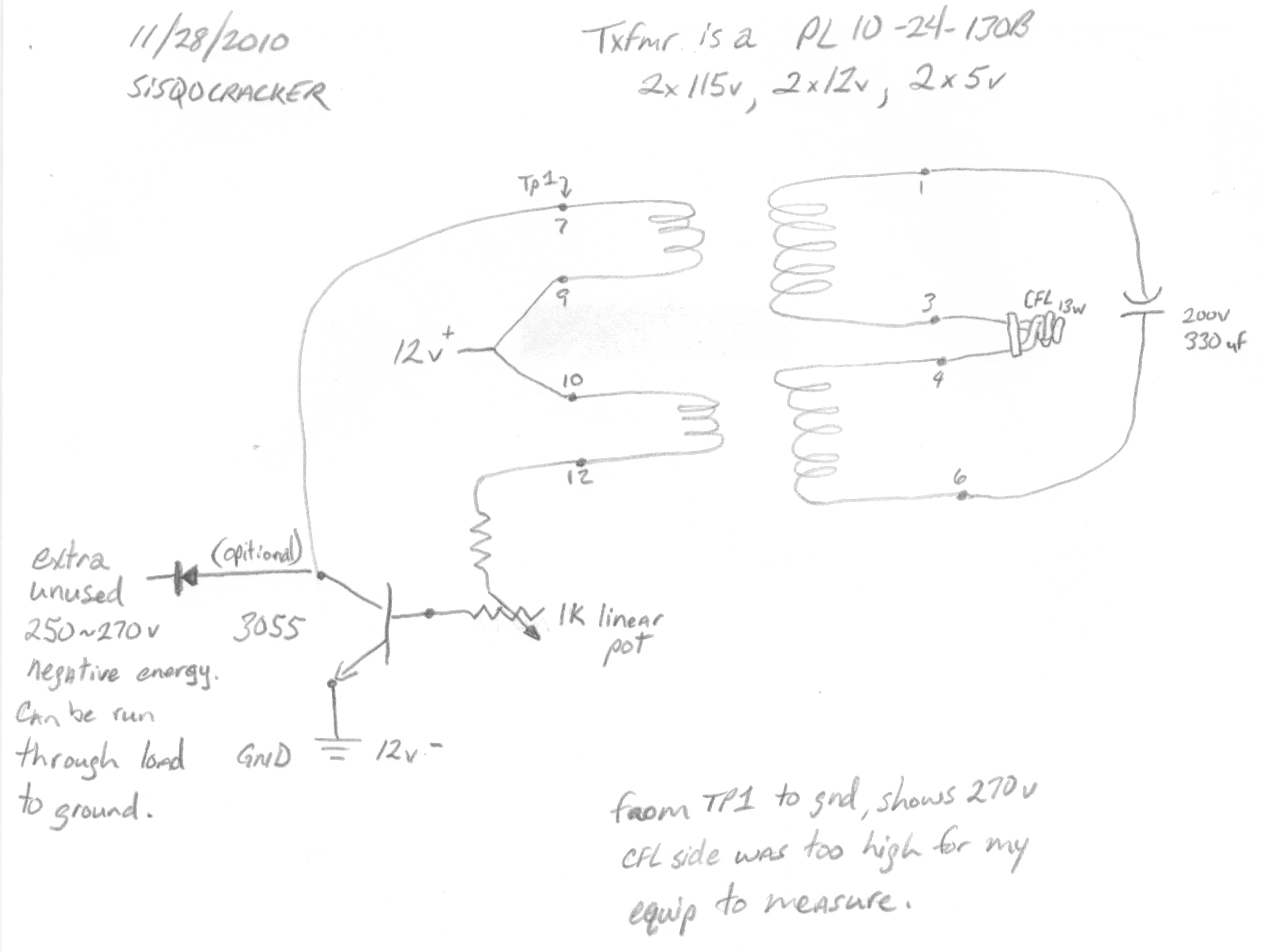

I know this appears to be just another JT circuit. And for the most part it is. What I like to do, is to try and find "off the shelf" products that can be re-purposed into JT circuits. And to scale them up, where I can. I've finally found, what I think, to be a good combination of common parts that folks can replicate this circuit with. Without maybe having all of the test equipment a lot of us have the benefit of using to tune these circuits.

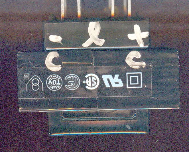

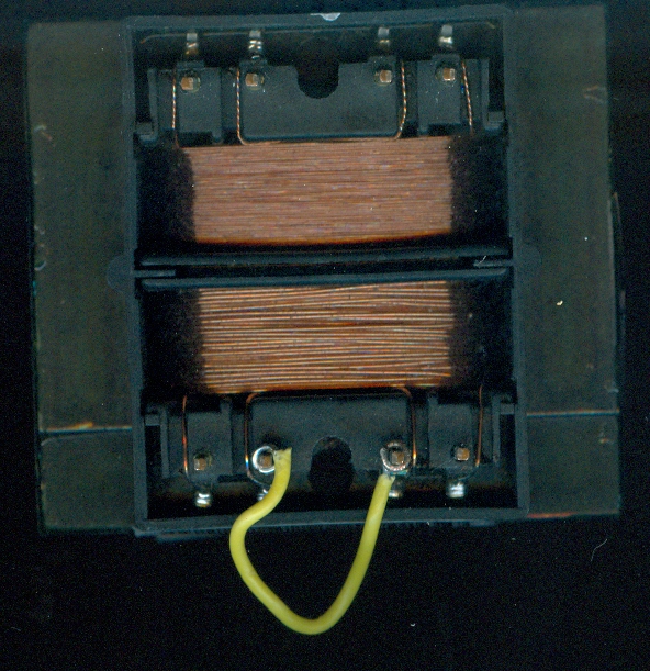

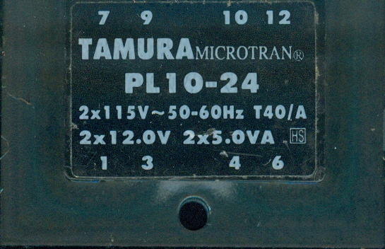

What I have here are a transformer I picked up from EPO (Electronic Parts Outlet) in Houston. It has a label of TAMURA microtran PL10-24-130B, 2x115v~ 50-60Hz T40/A, 2x12.0V, 2x5.0VA PL
It has posts numbered 1, 3, 4, & 6 on one side and 7, 9, 10 & 12 on the other. the side with the numbers 7-12 are larger gauge wire than the 1-6 side. So of course this smallest gauge wire on the transformer is meant for the 115v AC side, and then the larger gauge wire is meant for the 12v and 5v outputs.

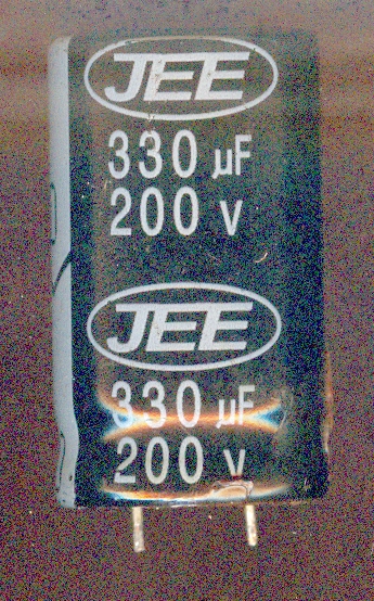

Next I have a common 3055 transistor that we're all familiar with on these forums. Nothing special there. Same goes for the rest of the parts list; I have one 200v 330uf capacitor, a fixed 2.2k 1/4 watt resistor that feeds into a 1k pot (1/2 watt or less), 13w CFL with the circuit removed and just using the wires leading out of the CFL itself.
Optionally you can run a diode (I used an N4006) to take the collapsing field from the collector of the 3055 and run another load through that, and into ground.
