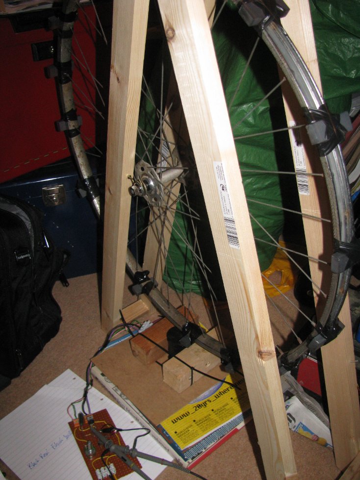

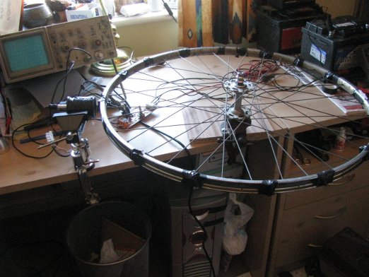

HAd to have have break. Hacked up a wooden frame and stuck my 25" bike wheel on it. Interesting how it is not balanced (I read some note about wheel rotation due to imbalance). Anyway. Very crude setup with the coil just held under it by taping it to a block - no point in doing more until I know it works.

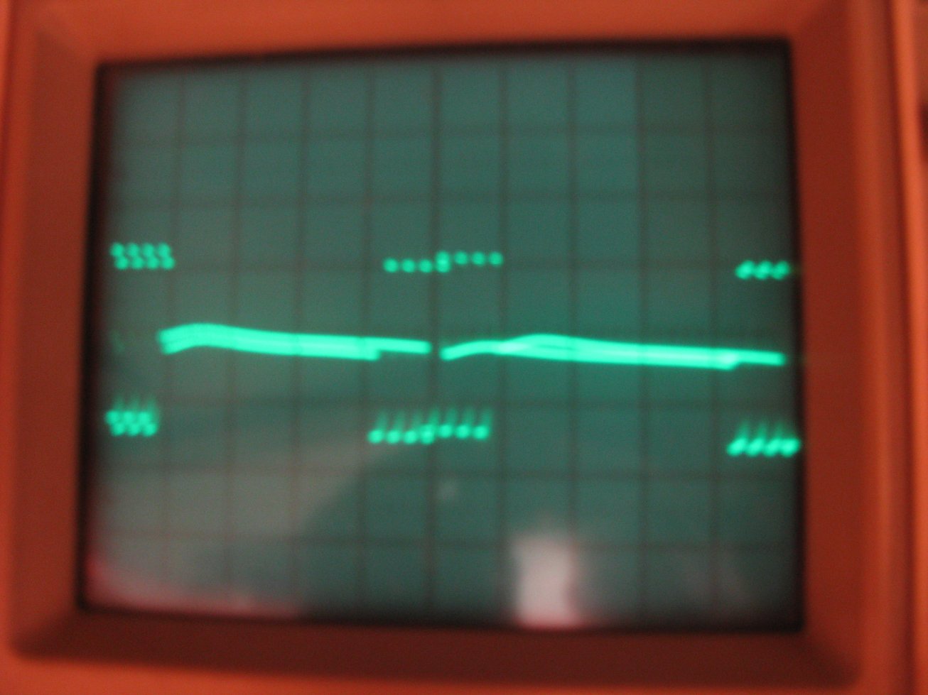

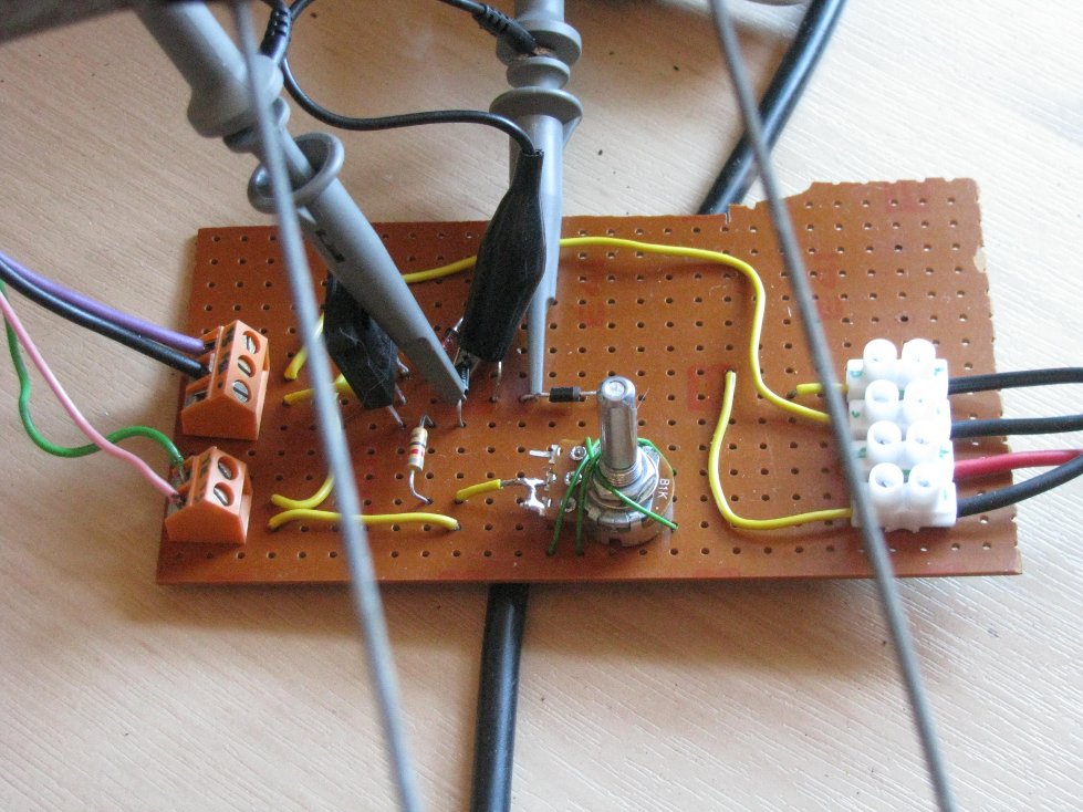

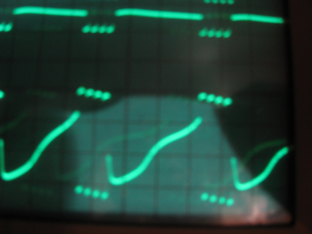

And he presto .. after blowing a trani as my load was not connected (need to get some 80V neons !!) it chunters along great. Pretty steady 85rpm. The suprising thing is that I needed min restsitance (ie max input current) to keep it going when horizontal, Now, max input slows it down, and the sweat spot (very crudely) is about 600 ohms. My induction current meter (not accurate I know but a good indicator) says 120-160ma (whereas before is was 800-950ma).
One battery is well bad so I gave it a soak charge and am using that as the source. The other larger on (65AH I stuck some lights on for an hour to load it a bit at the c20 rate) and its charging fine. Been running 8 hours now. Plan to run most of the day, then a long discharge at c20 and do that a few times to desulphate.
