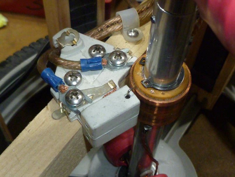

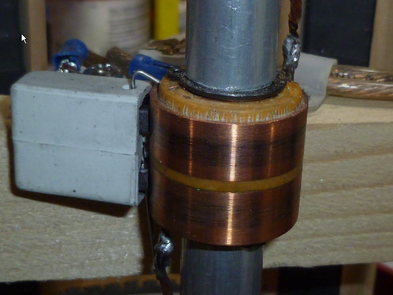

                    Maybe you could use a set of Government Motors slip rings. I pick these up at a motor rewind shop for $10 when I built my Kromrey Converter, it's already mounted on a insulator that's molded onto the rings. You could slot these into a commutator with a power hacksaw or the right cutting tool.
                    Could save a lot of time?
                    Merry Christmas, Mike

                    • Originally posted by Michael Kishline View Post
                      Greetings emfimp,
                      [ATTACH]7293[/ATTACH][ATTACH]7294[/ATTACH][ATTACH]7295[/ATTACH]
                      Nice Slip rings Mike. Also the delco brush holder is a nice piece to work with.
                      Just watched my video this morning, I recieved it on thursday but this morning early was my first opportunity. Thanks Peter, very inspiring and educational.
                      Slip rings can also be had from any Automotive electrical rebuilder. Alternators Parts,Slip rings, Lucas,Bosch,Delco,ford,valeo,paris rhone,hitachi,leece neville,ducellier,nippondenso,prestolite and mitsubishi is a good source and reference as well.
                      Not sure of the direction of my build yet but will be on the watch for components.
                      Bill H.
                      • Wow! Thanks Michael & Bill! These look like great replacements, & cheap too! Definitely going to be first on my list, to look these up...
