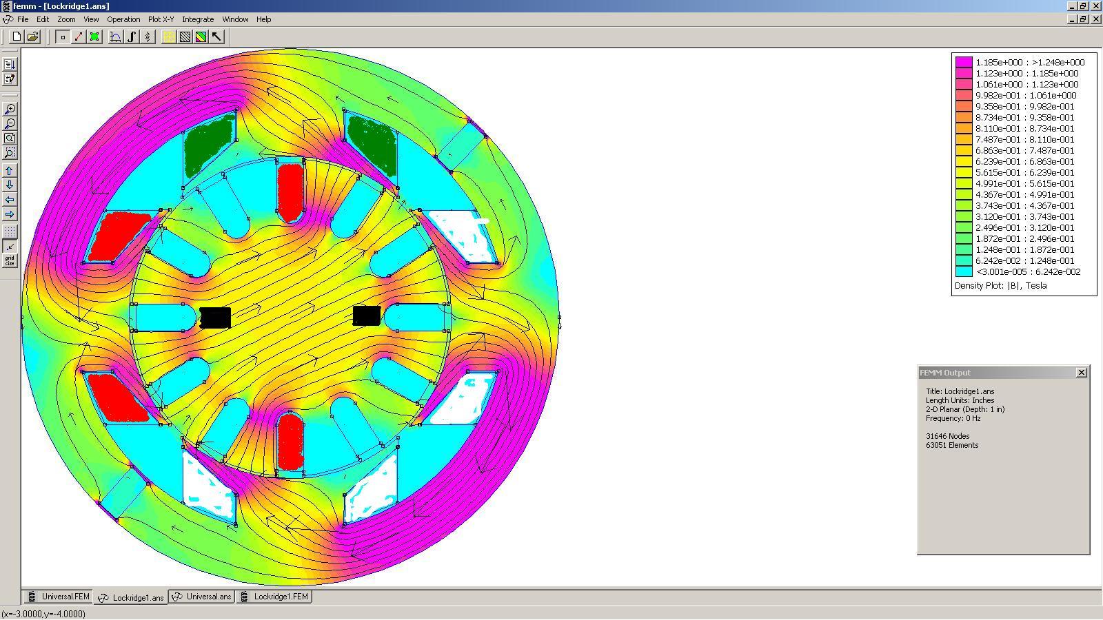

                            • This is about making the motor/generator part of the lockridge
                              Its quite simple really but making it happen takes a little work. You will need an AC or half way rectified AC or a pulsed DC supply for it to work although in the final device it will be pulsed DC
                              You need a 4 pole universal motor, these usually have four brushes on the armature but we will only use twoat this stage.
                              The 3 o'clock, 9 o'clock coils and the armature are powered in series through the brushes at the 3 o'clock and 9 o'clock positions. The motor is in magnetic lock when operated this way and will not turn.
                              Now take the 12 o'clock and 6 o'clock coils and connect them to a low resistance load. the motor may begin to turn
                              To improve motoring performance the 12 and 6 o'clock coils may have to be advanced or retarded to find the Ideal position.
                              A varying supply has to be used or you will not get transformer action. The transformer action powers the 12 an 6 o'clock coils giving an electrical output
                              As the motor is in magnetic lock, no BEMF is generated, even when the motor is turning little BEMF can be generated.
                              The motoring force is caused by the flux being compressed at one side of the 12 and 6 o'clock coils.
                              The motoring force is not good at this point as al the coils are interacting with each other and the flux is being shorted
                              To further improve motoring action we have to split the case length ways, just as in the lockridge device at the 1.30 and 7.30 positions and with fine tuning of the position of the 12 and 6 o'clock coils good motoring action takes place.
                              As the motor is now turning BEMF or forward generated current is occurring in the 12 and 6 o'clock coils.
                              An amplification of voltage occurs in the output.
                              See drawing of magnetic circuit

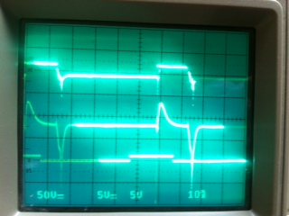

                              • 2-pole universal motor, bottom coil disconnected.
                                Pulsed at about 1000 RPM (16Hz) using 555's, 33% duty cycle and a relay. If I have time, I'll post all of the details to EF tomorrow. Otherwise, when I return in a week or so (remind me :-).
                                Top trace is across the modified motor. 50V/div.
                                Middle trace across the 2nd coil (disconnected, acting in transformer mode). 5V/div
                                Bottom trace is the dual-555 driver circuit hitting a relay, switching 24VDC pulses across the motor (major sparking across the contacts of the relay).
                                400V spikes on the motor side. 10X less on the 2nd coil side.
                                I also did scope shots before modifying the motor and not much was different (400V spikes). The results were essentially the same as the top trace. (The 400V spikes are barely visible, but they are there).
