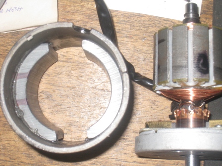

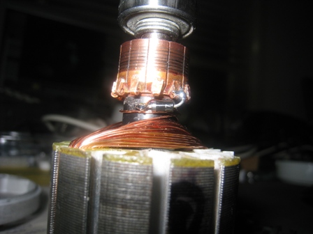

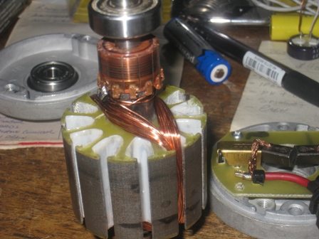

                  • Here's a few pics.
                    The magnet rotor was simply used as flywheel.
                    • Hi Penno64
                      With the 2 pole motor your using there is no way to wind a zig-zag style, that is for a 4 pole motor.
                      With the 2 pole motor you also dont need a diode. With a diode your motor will only fire 1 time per revolution. Without the diode it will fire twice per revolution.
                      You may also want to hook 2 commutator sections together where your coil wires are hooked up so you can have a longer "on" time. This will get that motor really going.
                      I also did not see any recovery brushes in your pictures. Without the recovery brushes you will have lots of arcing and will burn up your power brushes quickly.
                      I'm not sure how many volts you used to run your motor but you also need to increase the voltage, remember that the way your motor is now with only 1 pulse per revolution and only using 1 commutator section you have an effective on time of only 8-9%.

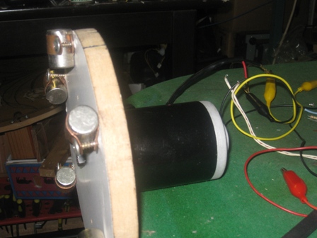

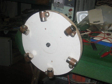

                        • Completed dynamometer.
                          • Dyno is now complete. Here is a video of the Green Machine motor under test. About 80 Watts of output power, 50% efficient.
