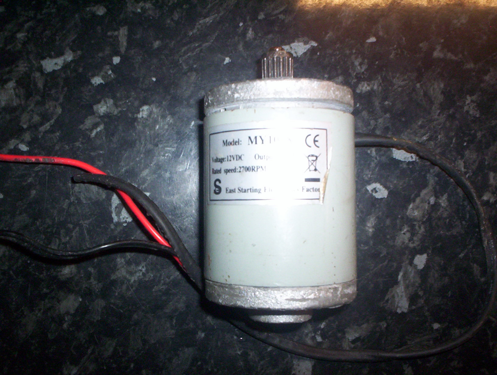

            • Got it Working
              Hi All,
              Here are a few pics of my build so far.
              ImageShack Album - 11 images
              The motor is one i pulled out of a childs scooter.
              It was easy to take the wire out and i was able to reuse it to wind my first set of coils.
              On this motor the brushes sit in the centre of the magnets so i wired the commutator sections that are in contact with the brushes when the slots that the coil is wound through are are directly above the brushes.
              I connected it up to a 12v battery and bingo it worked.
              Now Im searching through my scrap to find a suitable set of brushes for the recovery.
              Great work and thankyou.
              Pat

                      • What model ?
                        Originally posted by pattester View Post
                        Hi All,
                        Pat
                        What model and brand of scooter was it. Is it the same motor Matt was talking about ?
                        FRC
                        • Hi FRC
                          Im sorry i dont know the make and model of the scooter. I salvaged it a couple of years ago and weighed the frame in.
                          The model of my motor is the MY1018 from East Starting Electronics factory. here are the specs from their website.

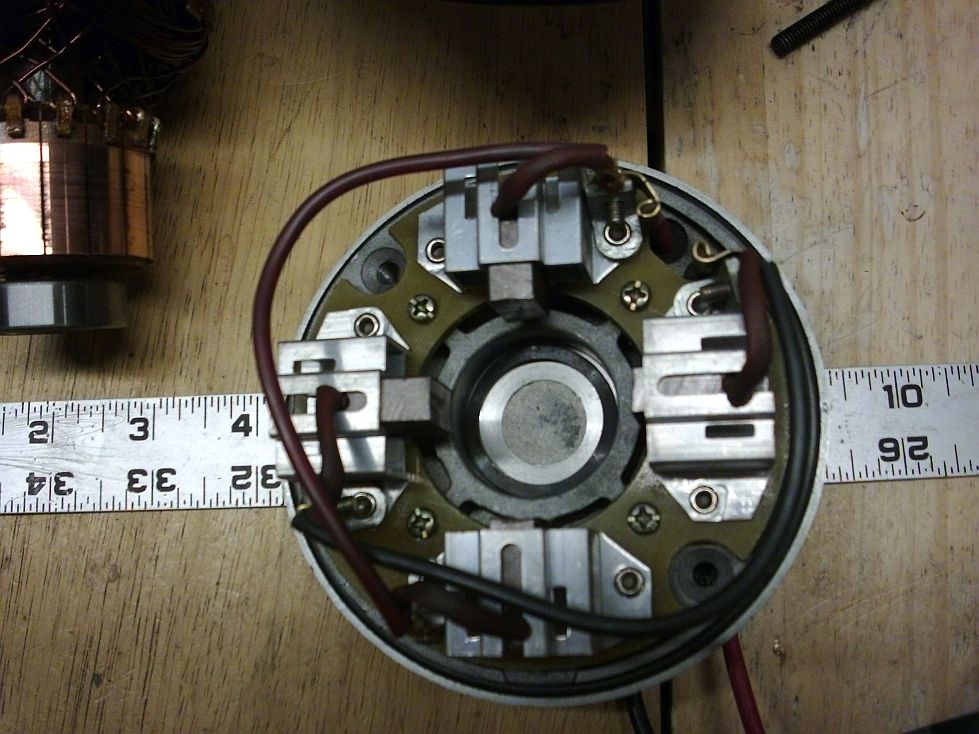

                          • Xyd-6a2
                            Originally posted by Mark View Post
                            Hey Guys,
                            I spent more time today cutting thru the insulators that are between the slots that hold the windings down on my rotor. Still can not get the wire out, there completely glued in. I am going to try and call the manufacturer on Moday to see if I could buy just a blank rotor with no wire on it. If I can I'll let everyone know. The motor is made by Currie Technologoes Inc. Model:XYD-6A2. DO NOT BUY THIS MOTOR FOR THIS PROJECT.
                            Mark
                            Mark,
                            I should have waited longer before getting this. I thought it was going to be like Matt's. It was very difficult to get all the wires out because of the glue as you mentioned, but I finally got it out. Now I have to figure out how to do the zig zag winding. Here are some of the before and after pictures:
                            ImageShack Album - 6 images
                            I tried the method of just cutting the wires on the commutators and leaving the 4 commutators uncut, but that didn't work (it wouldn't spin).
                            Brian

                              • Good Work n84dafun!
                                How did you get the insulators and wires out? I finally just gave up and ordered the motor Matt has. I'm still going to see if I can just buy some blank rotors, if I can I'll order 4 of them.
                                Did you remove the whole commutator board from the cover? Is that glued in too? Or did you just have to drill the top of the 4 studs down to remove it, assume that you did remove it.
                                Can I mail you my rotor so you can remove my winding? I'll give you $5.00.
