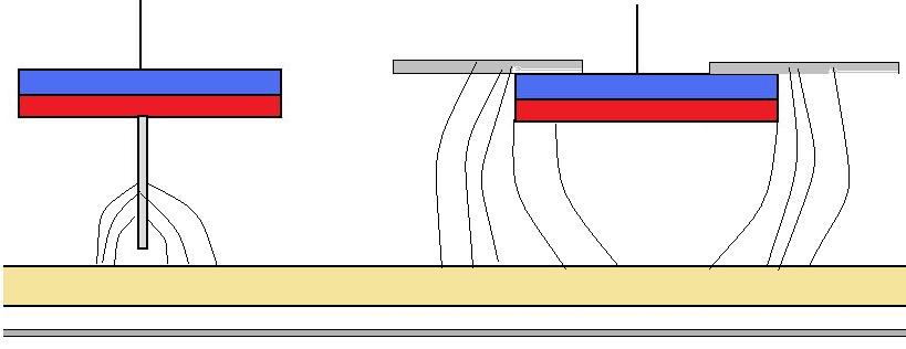

                        I attached a visualization of probable current flow in two setups. According to homopolar principles the first should give little to no torque.
                        However are you saying the illustrated magnetic orientation does not produce torque?
                        • #27
                          OK - if the second picture has a conductor which is horizontal then yes - this produces torque as the ionization current will flow at right angles to the b field along this conductor. The first picture shows a vertical conductor - right? Then yes, this doesnt produce any torque.
