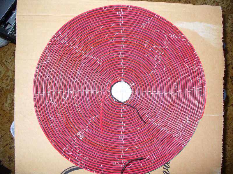

                  • #54
                    sry
                    just little attachment, my style of coil, Carton, Wire, Needle, thread.
                    But nothing extraodrinary in electrical measurment.
                    • #55
                      Really nice wind on the coil IWD.
