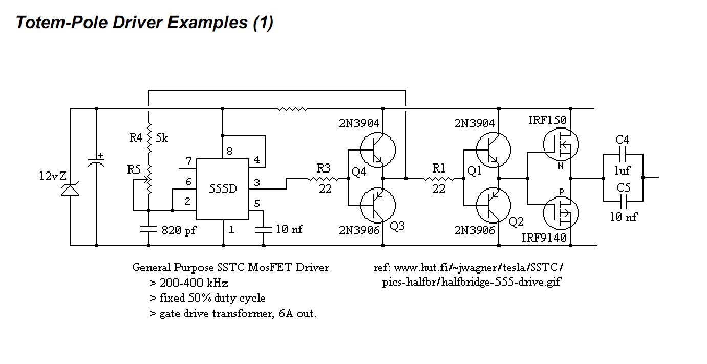

    I tested on the breadboard this circuit :
    And i think it must be very interesting circuit just if i knew how to
    make a few final steps...
    I mean, something strange is happening here, and someone should
    help me a little bit to understand it...
    If i connect battery positive to the top line of the schematic, and the
    battery negative to the bottom line of the schematic then i could not
    make this circuit to work, but if i in addition connect battery positive
    after these condensers (1 uf, and 10 nf which are in parallel position),
    than circuit works fine, and i can adjust with 100 K pot. draining of
    the battery between 50 and 450 mAmps...
    But the problem is that i do not know how to manage to get output
    from this circuit ? Where is the actually output in this circuit ?
    I didnt use zener diode, i just skipped that diode, nothing put instead of it !
    Thanks in advance !

      cikljamas, thats a totem pole Mosfet Gate driver with a fixed 50% duty cycle. The ouput is the one wire that come's from the center of the right side of the drawing, it go's from the two caps to the gate of the mosfet. It's only part of a full circuit, it's just the gate driver, and it's a complicated one. The description is there below the drawing.

              Farmhand, this circuit is desulfator, and i found it in one chapter that
              speaks about different kind of desulfators, i just could not figure out
              and i still cant where is the output ?
              And i would like to know where is the output in order to use this
              circuit as a charger since your 4001 desulfator is nice charger too...
              I already made another one (cikljamas improved,remember?)with
              555 timer, much simpler one with P type mosfet and this one works
              similar like this TOTEM one, i could not figure out where is the output
              in that circuit too, but since i used it as another part of that seems to
              be OU stuff together with your 4001 desulfator i did not care much
              about it in that particular moment, but now i am interested to figure
              out how to use these both circuit as chargers too, not just as desulfators...

              • Hi cikljamas, That circuit really is just an "example" of a totem pole MosFET driver.
                Desulfator Variations and Examples
                On this page it's the first of the Totem pole MosFET driver "examples". Don't you notice the circuit only has a very small capacitance and no inductors, it doesn't have the ability to output enough voltage and power to do anything much except drive the gate of a mosfet in a bigger circuit.
                This particular drawing and some others are just shown by the author of the page as examples, of driver circuits. If you look at the drawing right above it you can that one has inductors, large caps and Mosfets, it is an example of a parallel FET "charger desulfator", many of the circuits on that page are untested and are only meant as helpfull examples. If you scroll down you can see there are another two white papers with other examples of how to drive mosfets. And further down still is a pulse amplifier, it's not a desulfator either.
                You can design a circuit to use it with fairly easily, but all it can do on it's own is put out pulses the same as any other mosfet driver circuit.
                Rgds
                    Rgds
                    Thanks Farmhand !
                    I thought that this totem pole circuit is self sustained (no needing
                    inductor), and i thought that even more because i had same value
                    readings while testing with meter this pole circuit without inductor
                    and that one 555 with inductor...
                    But it seems that you suggest that this one also need in addition
                    at least inductor to be functional...
                    Never mind, i wont bother you any more about this subject since
                    your last answer was so clear and complete that i just have to
                    be completely content with it, and i am of course !
                    So, thanks once more for your patience with my so often beginners
                    and inadequate questions !
                    Cheers !
