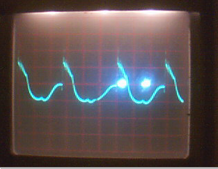

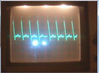

      Test #2 taken today for answer you:
      Power input drawing measured from Power Supply analog
      24v x 0.35amps = 8.4 watts
      I'm avoiding use DMM so please look scope shots
      first scope shows voltage on output with varistor connected using 1n4007 bridge diodes and 47 ohm resistor in series with varistor.
      Oscilloscope tuned:
      Time div / .1 ms
      Volt div / 100 volts
      second scope shows cur drawing taken from 47 ohm resistor
      Time div / .1ms
      Volt div / 5 volts
      Varistor is really pretty warm I can feel pain by putting my fingers in 5 seconds. I would try to measure temperature with DMM of my brother maybe tomorrow.

        Hi,
        No much need now for temperature measure.
        I assume the scope zero line is in the middle horizontal line in the second picture and somehow I suspect those spikes has less than 1.5V effective value.
        If you could span out the time base so that time division 1us or 10us then the area under the spike borderlines could be estimated much better, the area could be 'arranged' to be an equivalent rectangular with horizontal coverline instead of the spike shape. This ought to be made with the voltage spikes in the first shot too, unfortunately... by the way where is the zero line in it?
        Gyula

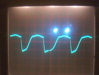

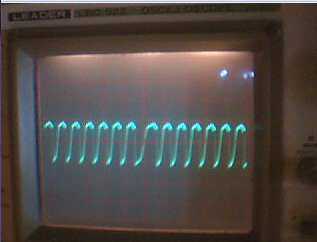

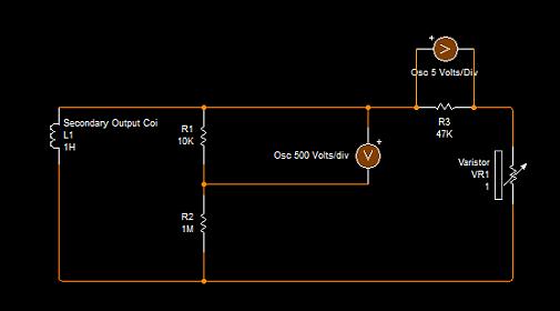

                    @Gyula
                    I've experimented big problems with my internet connection, rains is destroying all here in my country. But I'm here again
                    First shot Voltage shows some like sinewave 5 div /100
                    Second shot Current shows some strange effect 5 div.
                    The test was without diodes only coil output with resistors voltage divider for take the voltage and 47 ohm resistor to measure current
                    Both shots was taken on .2 ms Time /div
                    Steve Jobs. Apple CEO
                      Hi Patmac,
                      Thanks for the scopeshots. Would you explain where you placed the 47 Ohm for current measuring, into the primary or the secondary coil? The load was only the resistor divider across the secondary, 1MOhm + 10kOhm, correct?
                      If you could span out the time divisions from .2ms/DIV to 10 or 20usec so that say one or two full current wave period is shown on the display, it would be better. Also indicate zero line or state if it is always in the middle horizontally.
                      The current waveforms indeed look strange, I assume you can influence the shape by tuning/changing the input pulse frequency AND changing the amount of input current by reducing input 24V DC. Normally for a transformer secondary coil with having roughly sinusoidal voltage waveshape the current shape is also roughly sinusoidal with the resistive loading unless the transformer core manifests already nonlinearity.
                      Just thinking: the permanent magnet in the middle biases the core towards one direction, ok? it means that the operating point of the core got shifted from the zero middle point (unbiased case) to either upwards or downwards alongside the B/H curve, depending on the magnets inserted polarity direction. Now, when the input pulse appears, there can be two directions the operating point can move further alongside the curve from that of the point the magnets shifted it: further up or further down. In case the flux of the input current helps the magnet flux, i.e. adds to it then the core gets even closer to saturation and in case the flux from input current works against the magnet flux, the operating point gets move to the opposite direction from the point the magnet statically shifted it, in this latter case the control range can be much wider for the core but you have to sacrifice some input power to work against the permanent magnet flux...
                      rgds, Gyula

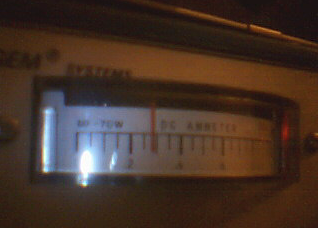

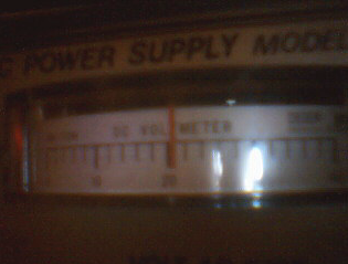

                        Explication of Test Setup:
                        This very last shots was taken with Input 21V @ 0.3A, reading the analog power supply look the attach.
                        The very first shots was taken by rectifying the output, but to avoid confussions I've removed the diodes bridge two last test.
                        All test setups the output current was measured with 47ohm resistor on Secondary Coil in series with the LOAD (Varistor).
                        With or Without diodes Varistor gets really warm impossible resist the heat in the fingers.
                        The logic circuit is a TL494 reducing the square wave a little (35-40%)this produces me better results. This TL494 is connected to my lead acid batt @12 Volts fall apart from input source to avoid frequency change when I change the input voltage.
                        Really I think Naudins use a Carbon conditioned resistor or MOV because this produces a near perfect Sine Wave, in my case is near, maybe I need test with many MOV types and specifications. Sine wave is usefull to use another inductor to reconvert the output energy and try self loop for example. But is really usefull to precisely calculate the COP; Naudins talk about this:
                        THS720P measurement error*with non sinusoidal waves
                        If we look his output shots we can confirm the near perfect Sine wave. But output is really good too when this wave out of shape. I can change the wave by changing the frequency or the Voltage both methods can produces results identical.
                        Regards...
