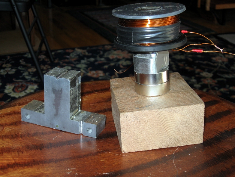

                        Running 12 volt setup, opto triggered Mosfet, no weight yet, just plain disc...
                        Coil looks like this (pic 1)
                        Setup looks like this (pic two)
                        Ron

                          Coil is bifilar, .034 wire, 345 turns finish of one to start of two. 3.7 ohms total, both winds. Zero gauss on exposed pole piece at 11.7 volts.
                          Runs around 900 RPM and .2 amps draw, no diode. Firing about 40%, on for
                          approach, switch off at TDC
                          Ron

                              It is not a solid core, just a chunk of laminated MOT core, whittled down.
                              I was imitating gap power and only winding half the core.
                              Sounds like you are driving the core well past the zero gauss point?
                              Ron
