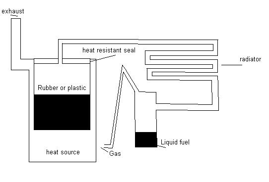

                The process is really easy. you have a metal container filled with plastic or rubber, you get a way to heat that container to about 400-500 degree celsius, no matter whether with fire or with resistance heating elements. You have a pipe going off the reaction chamber that hoes though some lops of metal tubing or a radiator so that the hot vapors can condense. In this condensation process the liquids separate from gasses. The gasses can be burned right away and the liquid collected. There is no pressure in the reaction chamber because it is connected to the atmosphere via the radiator and gas outlet so no pressure and thus much safer. Hope this helps. Let me know if you have any questions.

                    Hi bboj
                    I was thinking of simply drilling a hole in the pressure relief valve of the as yet not found pressure cooker, attach a pipe from the valve to a bubbler, a pipe from the top of the bubbler to a torch, so once you have got the reaction started the let off gas may be enough to sustain the reaction vie the torch, when enough oil is produced syphon it off
