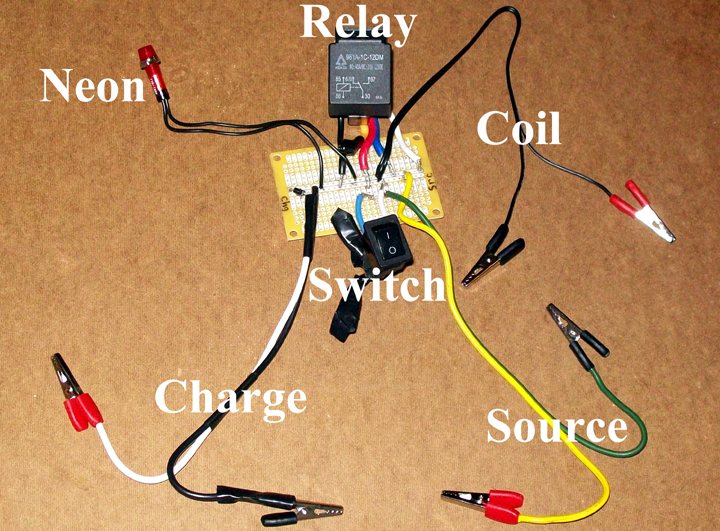

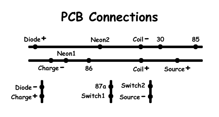

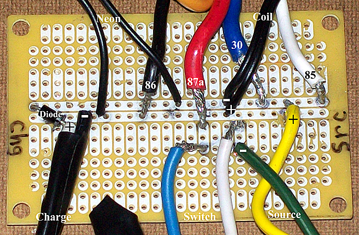

      I'm still scratching my head over this one, though. I've attached pics of my setup.
      If anyone can tell me where I'm going wrong, I'd appreciate it. Thanks.
      - Godfrey

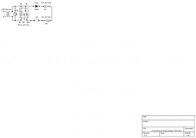

              I'm still not getting why my ignition coil causes my circuit to fail. I have attached a schematic for further clarity. As you can see, there is no connection to the secondary. Maybe this needs a load like a CFL?

                              Here is my proto board w/terminal strips:
                              I decided to start by trying some basic configs (before incorporating your cap/pot idea).
                              This is the first circuit I've been testing (not an approach you recommended, but wanted to rule it out):
                              Here is a diagram of the terminal board:
                              This time the coil worked. In fact, disconnecting the coil turned off the circuit. But the results were mixed. The neon does not light in test mode. I can't get a neon bulb or CFL to light if attached to the Charge Battery leads. The spikes seem to occur, however.
                              It's difficult to measure results. Got any tips for detecting radiant spikes?
