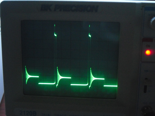

          Thank you Lee!
          I've attached a pic of the oscilloscope shot with the probe connected as you suggested. This is on my 'Rodini' solid state - which is a bedini SSG circuit with a Rodin Coil in place of Bedini's second ('B') coil, and it easily enters a solid-state resonance mode in many configurations.
          So, the oscilloscope is set at 0.1 mS/div, 5.0 V/div. The signal repeats 3 times across the 10 divisions of the screen. Not such an 'H' shape, but the Rodin Coil changes things up.

              Hi geminitric,
              I have a problem with your scope waveform. This is not typical of a solid state oscillation waveform, this is more typical of a driven transistor on a 50/50 duty. The coil is discharging to a voltage much greater that the supply voltage and, if this were solid state, the transistor would re-trigger on the first oscillation below primary voltage after the collapse, therefore not allowing the damped oscillation to occur after the collapse, as seen in your scope shot. Without a clear schematic of your circuit, I can only conclude that this is not the waveform of a self oscillating circuit.
                  Hi Lee, thanks for the continued input as this discussion is helping me figure out what I'm seeing. I can assure you this is solid-state oscillation; take a look at this vid to see how the device was working at the time that I took those photos.
