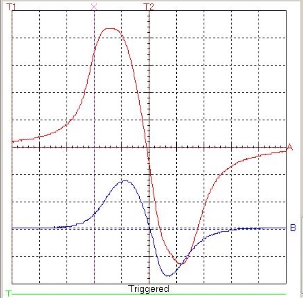

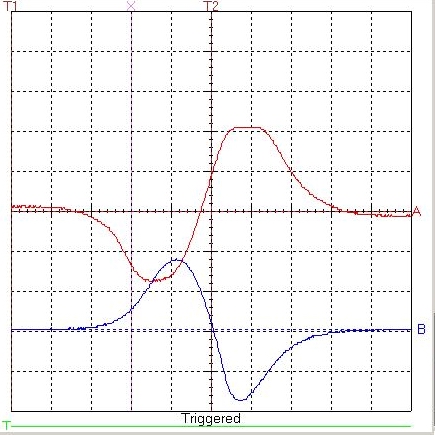

The first picture, "8e", shows the flux plot, Channel A, of a gauss meter hall probe at the outboard end of the core. The hall probe is inserted so as a north pole on the rotor gives a rising sine on the gauss meter.
It can be seen that the flux plot is exactly similar to a voltage plot.
In the second picture the coil has been shorted... the polarity of the flux field is exactly reversed!

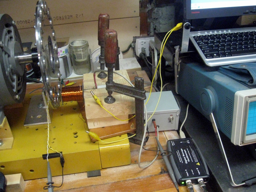

Here is a picture of the setup... the core is about 5/8 X 7/16 X 3 3/4 inches,Originally posted by madMAx4 View PostI agree, zero crossing is usually at TDC.
@Ron: what resistance does your coil have, and how long is it? And what core does it have, what diameter?
about 1/2 an ohm, 4 mH, the coil is about 2 1/4 inches long.
One doesn't have to use a gauss meter, a small sensing coil over/behind the main coil will show the same thing?
Ron
edit... oh, not the same coil as in the pic, but same core, this coil above was large gauge wire wound to see if there was any difference in the reversal... there wasn't
edit 2, please note that air cored coils react differently... the scope shots only apply to steel laminate cores.Last edited by i_ron; 07-28-2010, 11:13 PM.

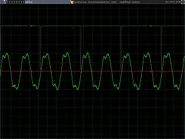

Max,Originally posted by madMAx4 View PostI agree, zero crossing is usually at TDC.
Those dips at the sinus maxs are because of the bad shape of my magnets, 15mm x 8mm. They need to be longer.

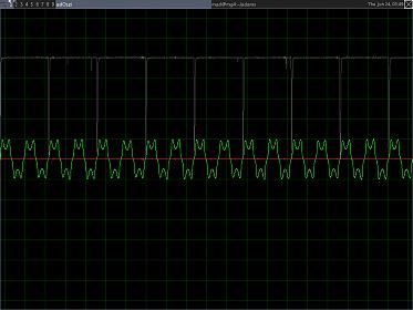

I think you will find the it is the magnet spacing that causes the "M wave"
The incoming pole's sine must precisely overlay the outgoing magnet's sine to make an exact sinewave...in other words, magnet spacing
Ron
edit: in an NSNS rotor
