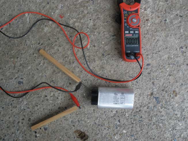

now lookin better at the cap, the thing comming from one leg of my capacitor says "HVR3-9" and have the symbol of a diode... maybe that is the "bleeding diode" that discharge the voltage slowly to the metal box of the MO?
if someone please can help, i will try this experiment in one hour, will try to make a video to... if im not completely shore i will not use the capacitor like woopy!
i will take all the safety cares! hugs

Hi juju
my complete kapagen coil is resistance at 0.2 ohm and 0.22 mh.
Just a little thing for the HV cap. If on your cap you have a drawing showing a resistor, as per the pix, that means that the cap will self discharge and very short time (on minute or so). And than before touching anything i make a check with 2 nails in long wooden bar so no HV danger,
hope this help
Laurent
