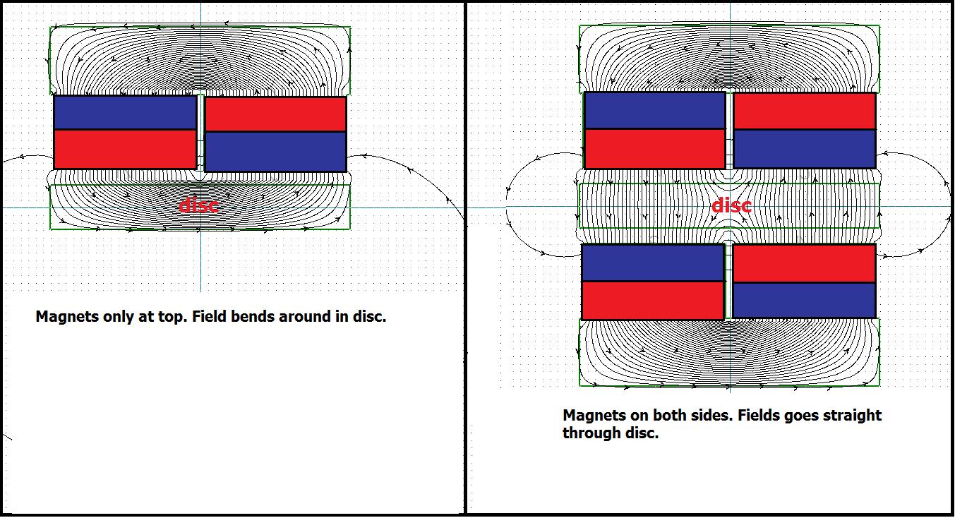

                      • Originally posted by witsend View Post
                        Hello gravityblock. I watched your video. Bit dark - but I think I saw it right. Effectively you're showing that if two Souths (say) are attached to some magnetic material the fields can attract on the other side - and if you take two north souths then it no longer attracts magnetic material. Presumably using just one magnet it would attract on the other side? I've been looking for something small enough to test this and I only have ferrite magnets. I'll check it out in the morning.
                        First off I'd say that the ns alignments actually bypass the attached and simply combine their fields. That would argue to less magnetic fields intruding into the material that hold both magnets. Surely? Conversely two souths would stay apart and their fields would be accessible to any proximate magnetic material. So. The same effect - but a different explanation.
                        Yes, with only one magnet, the other side will have a magnetic field and will be attractive. If your using ferrite magnets, then make sure the metal piece isn't much larger than the size of the magnets, because the field will be spread out over a larger area according to the size of the metal and will be weakened, thus the attraction will be lower and may not be noticeable.
                        In the N/S alignment, the field does not bypass the attached metal piece, but will actually flow inside it. This can be seen when the metal piece is over-saturated and the field will leak through the other side, which will cause attraction.
                        I'm attaching a simulation showing how the N/S arrangement actually flows inside the material (left half of the image). On the right half of the image, then the field will pass through the other side of the material if another magnet of opposite polarity is on the other side. The piece labeled "disc" in the illustration is a ferromagnetic material.
                        GB
