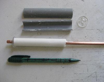

            Sadly the BaTiO3 one didn't work (K around 2, same as the wax alone.) See attached photos. It has worked fine in the past when I made a flat plate capacitor but as you can see in the photos I'm making a cylindrical one and I have to pour the mix into a small gap (5mm) around the central rod electrode and the thick BaTiO3 portion of the mix doesn't pour well. Instead only the liquid, primarily wax portion pours in. A similar issue caused my BaTiO3/epoxy mix to not work out.
            But I think I've finally figured out how to do it. I'll go back to using BaTiO3/epoxy since that'll give me a 20 minute working time and I'll tamp in the thick stuff. I'll also use a transparent mold so I can see the result of the tamping as I go along.

              I just finished about 2 weeks of work on figuring out how to make the best barium titanate dielectric for my cylindrical capacitor. The way that worked as to create a thick sludge of BaTiO3 (80%) and a slow curing epoxy (20%) (slow curing so that I had a long working time) and to push this into a mold and tamp it down as I went along. This gave me a dielectric constant of 15. I also tried BaTiO3 and wax but the mix cools too fast them trying to get it into the thin mold. A BaTiO3/wax mix has worked for me before but only with a large mold where I could quickly dump it all in place. That gave me a K of around 15 too.
              Things that didn't work were whenever the mix was liquidy (to low a percentage of BaTiO3) and when pure BaTiO3 powder was used but not under abnormal pressure (too much low dielectric constant air.)
              Full details of all my efforts can be found at:
              Barium Titanate Capacitor (BaTiO3)
              Aaron, a K of 15 with the measured capacitance I got suits my needs. I think you need a much higher K but at least I've documented a lot of things for you that you won't need to try, if you're going to that is.

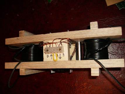

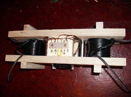

                Here is my Bedini Window motor.....
                I learned a lot and I liked my idea of how to mount the magnets with slots so that I can just change the inserts and change the magnet types, sizes, etc......
                I am now working on the basics of a Steorn e-Orbo but I do not know the secrets so it is just the basic build so far.....
                Winding toroids is a real pain.....LOL.... I have talked to a couple local coil winding companies and I may leave that part to them and their really cool coil winding machines.....

                    Very cool! Thanks for the tip. With the resin the best ratio I can get is 80% barium titanate to 20% epoxy - beyond that I can't bind any more powder to the epoxy. But I haven't gotten far enough with wax to see what the best ratio I can get that way is. Now I can take the process farther and see.
                    I did crack open another mold today and found that tamping doesn't work very well when the gap I have to tamp in is just 2.5mm. But that's okay. The 6mm gap that I documented on my webpage:
                    Barium Titanate and Epoxy Cylindrical Capacitor - K=15 (April 15, 2010)
                    gives me a good enough capacitance (75pF) and K (15) to start with.
                    Thanks again!
