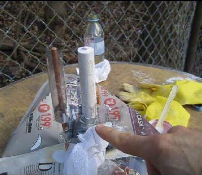

Well, I'm in the midst of building a Barium Titinate dielectric cylindrical capacitor. My calcs told me I can either go with a impractically high voltage or a small radius that would break down under the voltage anyway or a higher K dielectric. This is for testing a variation of Aaron's Gray Tube Replication circuit guided by my particle creation from vacuum energy theory (http://rimstar.org/sdenergy/vacuum_energy). It turns out that Aaron's circuit is a nice fit for this theory.
I just got through making a BaTiO3/epoxy one (38% BaTiO3 by weight) but the K is only 3, just a little higher than the K of the epoxy alone. I've had a K in the 12 to 18 range with flat BaTiO3/wax capacitors before so I'm in the process of making a cylindrical version today. The attached photo is from the build of the BaTiO3/epoxy one. I was going to make two at the same time but ended up doing just one.

I made my BaTiO3/Paraffin wax one today and I'll crack open the mold and test it tomorrow. I did run into some pouring problems so I may have to try again. But the details may be getting away from the purpose that Vicker made this thread for. Maybe we should create a thread about making Barium Titanate dielectrics?
