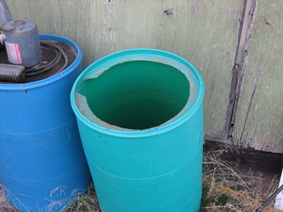

                more pics...

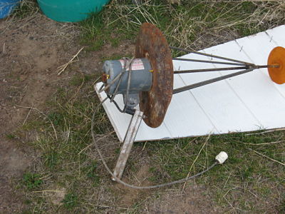

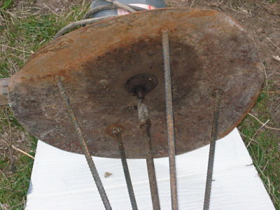

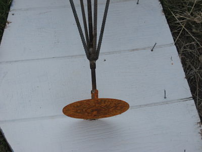

                one pic showing how I cut the top out of my used plastic barrels I pick up for free at a local farm co-op.
                and a few close ups of the mixer for the bio-diesel....this mixer was the second I made and used the top of a steel barrel for the large round disk the motor was mounted to...it was a little flimsy as it was thin sheet metal unlike the first one that was heavier gage material. And it has surface rust on it as its set outside through winter. I know my bio-diesel equip is not all pretty like you see many people make...its more of a down and dirty "Get er done" style functional units. Used veggie oil and bio-diesel is a messy process and I do not care what the equipment looks like as long as it does what i want it to do and do it fast as possible to get the job done at hand in the least amount of time and labor. I could have made a nice pretty 50 gallon a day processor that cost 20 times as much and does 10 times less, but for what purpose?...so I have a pretty processor to look at?
                here are the pics.

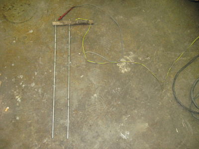

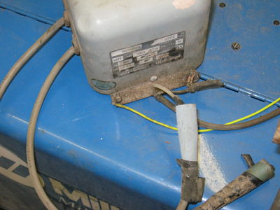

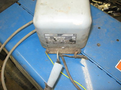

                  7000 volt fast settling wand
                  I found my 7,000 Volt transformer and stainless steel hand wand for the quick settling out of the glycerin as before stated.
                  After finding out this could be done with a transformer I rounded up all the components I had on hand and in 20 minutes or less came up with this for my first build, I was in a hurry to try it out as I was excited to find out about this ....so since it worked so well never have refined it as of yet. Maybe this year will get around to that. I have used this unit to make around 2,800 gallons so far in 30 gallon batches using this same device seen.
                  I mentioned before (from memory which is not always accurate it seems any more) I thought I had used 10-330 ohm resisters twisted together, but seems this has about 5-22kohm 5% 1/4 watt resistors (red red orange gold) In the pics notice only one neon transformer lead is used, other yellow lead goes to one stainless rod and grounded to case and other lead is from the center of one of the Neon transformer wires coming out of the case (HV) and the shielding woven wire around same wire is connected to the resistors and also grounded to other case screw.
                  I used an old probe and wire from a multi-meter and just stuck the probe between the rod and handle and connected the other end to the center of the only transformer wire used as described above.
                  This set up seemed to work quite well for doing the job.
                  Hope this is not too confusing with pics supplied

                    Wand and Rods for HV settling of glycerin
                    I just double checked my wooden handle measurements and they are as follows.
                    Closet wooden dowel is 12" long and stainless rods are 4 inches apart in photo above.
                    24
