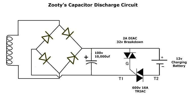

    Hi all,
    I came up with a simple cap discharge circuit that gives great results. It's basically a diac triggering a triac when the cap reaches 32v. I saw someone using a neon to trigger the triac but the voltage is much higher like that. The output of this circuit is very similar to the 555 timer setup Bedini uses on the trifilar monopole motors but is much simpler. The downside is i cannot control the voltage at which the cap is discharged. It is fixed at 32v due to the diac's breakdown voltage. If anyone can improve this, please go ahead. The charging results are great.

    Thanks for sharing this circuit. Please post part numbers for the triac and diac. Kooler and I have been using neons to trigger an SCR as in following circuit.
    circuit: http://www.overunity.com/index.php?a...0;attach=39943
      The Diac is a DB3 and the Triac is a BTA16-600B .. Both bought from maplin
        Can't you just replace the diac with a zener diode of the desired voltage?
          Actually that is a good idea Jetijs. I must admit i am new to these components.

            I did find that the scr goes short circuit if I charge up a large cap like in your diagram.
            I will definitely try your circuit . Can I use a scr in place of the triac. TYN612, 600v 12A
              Thanks. I have tried zeners and they work. But they fire at much lower voltages than their rating and they do not seem to fire at the same voltage all of the time.
                I find this circuit to be the most reliable of the ones i have tried in the past. It never gets stuck and it always discharges at the the diac breakdown voltage. When i used an scr, the one thing i noticed is if the cap was too small in capacity, the spike would overshoot the cap and cause the the scr to latch prematurely. I also found that scr's would frequently get stuck for no apparent reason. The other thing with this circuit is it discharges the cap on the negative side of the battery like in Bedini's 555 timer setup. According to some, this gives a better charging result. I will be doing cop tests soon.
                @nvisser, i dont have enough experience to know if an scr would work in place of the triac but i dont see why not, the ones i have used have always gotten stuck but it may have been the ratting or something. The DB3's are the small blue things yes..
                    Great information, thanks. I do have problems with the SCR latching sometimes.
