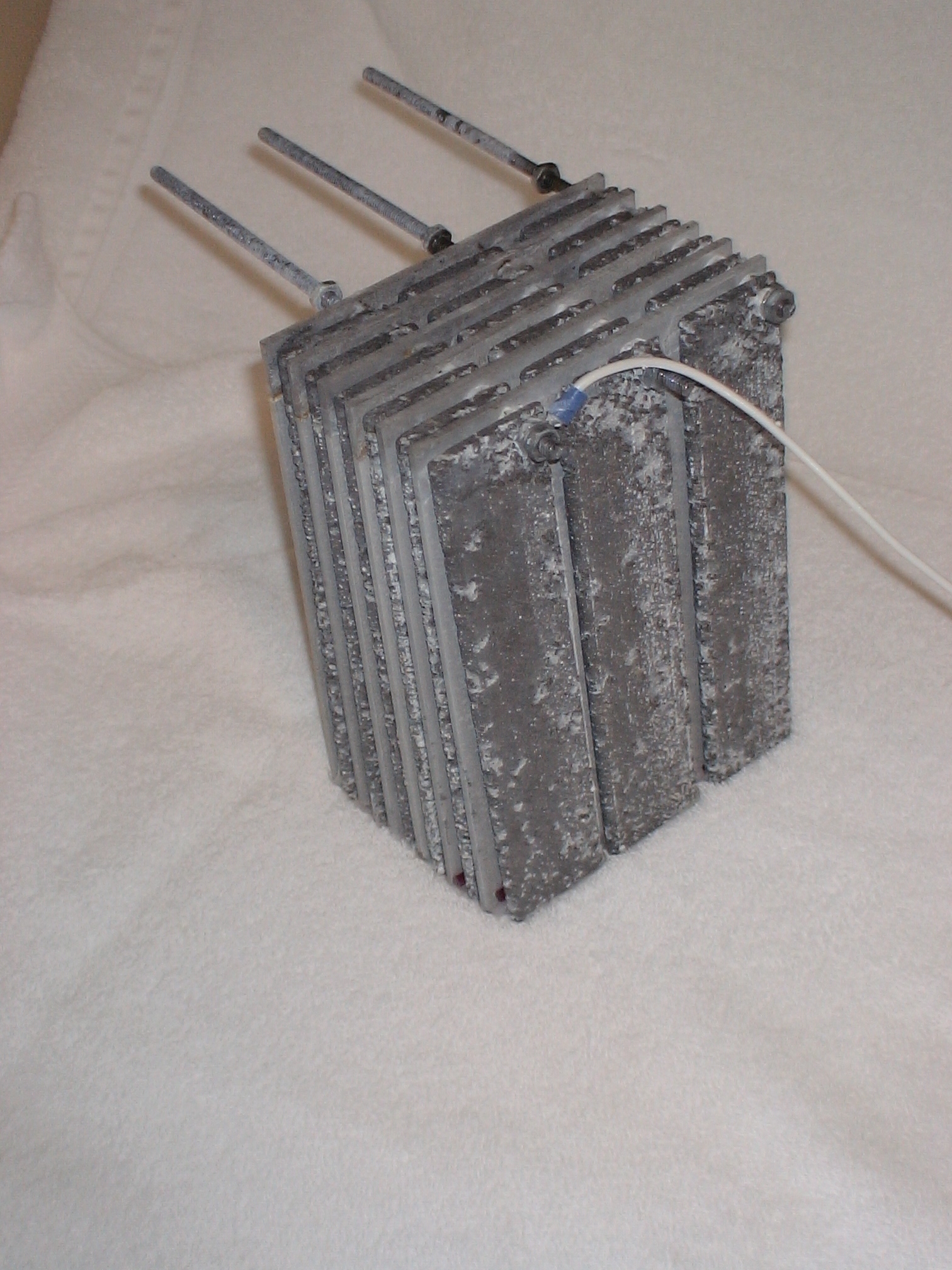

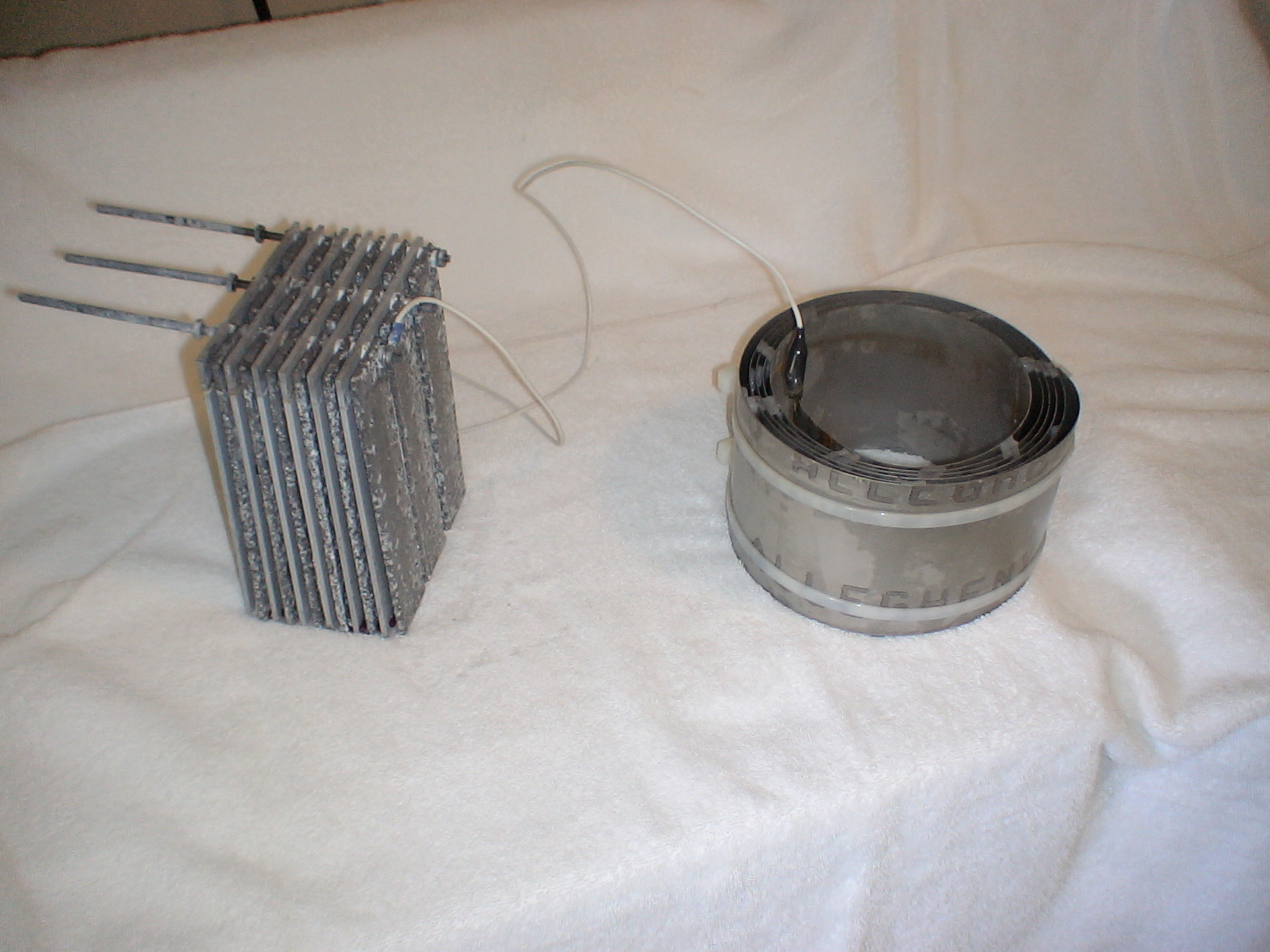

                    • No Pictures of my test device
                      Hello Everyone,
                      Thank you for your input. I am attaching jpegs of my test set up. It is crude, but adequate to prove the results.
                      The aluminum plates are 5.00 inches wide, 7.18 inches tall, and .125 inches thick. The magnesium plates are 1.50 inches wide, 7.18 inches tall, and .18 inch thick. The magnesium plates and the sizes I purchased are the result of what was available on E bay. The assembly of AL/Mg plates consisted of three plates of Mg on one layer and one plate of Al. The image will make this description clearer.
                      The coil of stainless steel is 4.5 inches tall, 96.0 inches long, and .025 inches thick.
                      The Al/Mg assembly was in one plastic tank of water that I added sea-salt that is normally used for salt water aquariums. The SS coil was placed in another plastic tank with the sea-salt added. I connected the Al/Mg assembly to the SS coil with a 14gauge wire.
                      ANY and ALL input would be GREATLY appreciated. I am going to get some seawater from the Gulf of Mexico tomorrow.
                      Thanks,
                      Bill
                      P. S. How do I attach images I have no idea about my URL.

                              I am attempting to attach some images. The Mg/AL is in one tank of seawater and the SS coil is in another.
                              Bill
