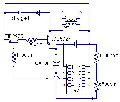

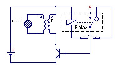

    About negative ion generator, would you use radiant oscillator? I find them produce a lot of ion wind. Strong enough to blow thin paper if you use sharp needle. Use shielded wire before the needle to make the ion wind stronger. To find the negative of secondary terminal use neon bulb. The negative is the one connected to electrode that glow more.
    I am not sure what you meant, could you be more specific please, or even better post a circuit schematic.
    My understanding is that a radiant oscillator would not produce sufficient HV to create ions, as voltage needed is in the range of 3-5kV and up?
      Use coil with high voltage multiplication factor. And off course you need current to get ion. I attach the circuit I would use for ion generator. All of them use 9V/220V 1A transformer. produce 0.5cm spark which I think is the sign HV.
