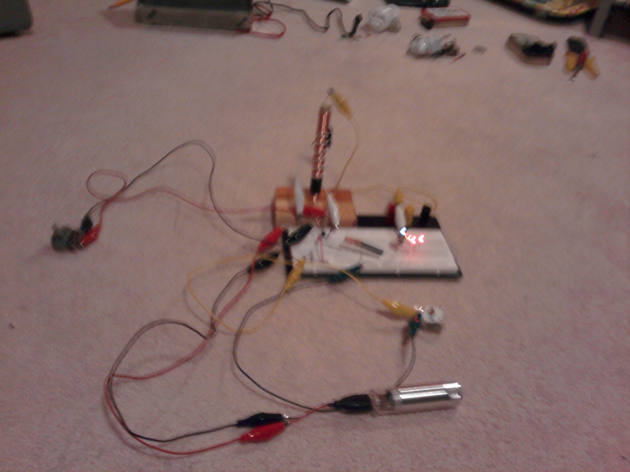

              simple exciter circuit but im using an mps2222 and a 1k pot, which allows me to tune it down to run from the AA. my "tray" is currently an old HD aluminum case. the LED's cohere from a good 3 inches away but only when i ground them with my body.
              next step, more towers!

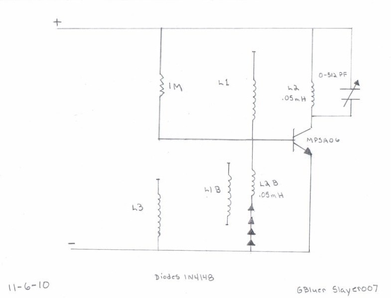

                  • Here is an Exciter circuit that works very good on higher voltages.
                    The C2 cap helps control the current intake along with tunning the Exciter.
                    The L2b inductor is another pancake coil just like L2.

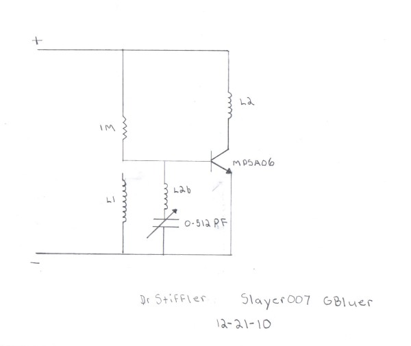

                        But here is another circuit that will work very good with smaller coils.
                        This one is kinda a Stiffler Slayer hybrid.
                        I just put this togeather with a few coils I had sitting around.It should work better with a little variation.
                        Also I haven't tried any coils off the collector yet.
                        Here is a video of it.
                        YouTube - Stiffler Slayer Exciter

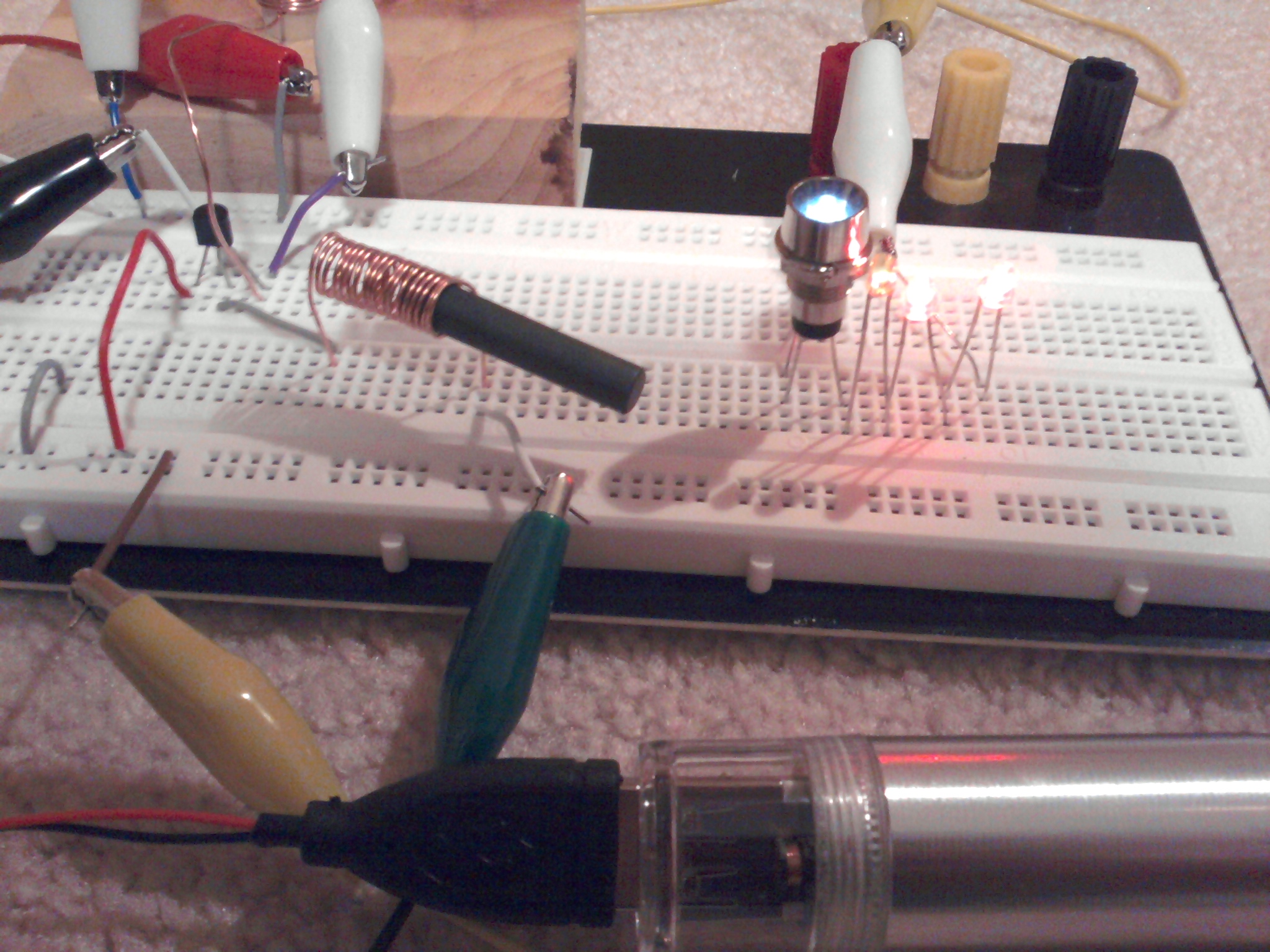

                        • well ill be dahmed that configuration made it work
                          unfortunately i had no tunable capacitors with that value and i used one i found laying around with an unknown value. it worked but only with a potentiometer with like 20 k ohms or something like that and getting both of them in that sweet spot is a drag. especially considering every time i would tune the variable cap i use my hands and i guess my parasitic capacitance screwed it up
                          but i got it working and considering it lit up several series leds with only a 15 milli amp draw is pretty sweet. -using AA cell phone charger-

                            • it turns out it lights just as well off of the collector of the transistor and for me oddly enough it requires no or limited additional tuning from when it was connected to the emitter... weird
                              i can't get the multiple sweet spot thing though. Other than that I get the same effects detailed in your vid with not really making a field off of the inductor tower, have yet to try a top load (i think thats what the metal piece is called forgive my being new to this). anyway just kind of a replication of your vid. the fact that the cell phone charger light dosn't come on is an indication that amp draws are very low.
