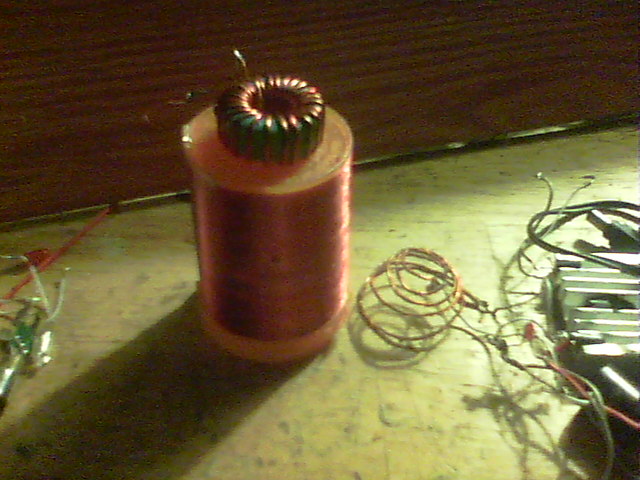

    Cheers xee2...I think a large part of this may be that i've wound bunches of micro aircraft coils in the past and so can readily 'knock one out' where other folks may suffer frustrations. 6 or so hours to wind a 'Windsor' is quite ridiculous isn't it lol
    The toroid is from some random junkbox circuit board from a while ago, when I was looking at Joule Thief's and purely magnetic induction based wireless circuits. It sits near enough just as it came off the circuit board and the idea had been to rewind it. Any toroid will do...if I solder one to another sat on top and then another on top of that, the plasma will still work from the Space Shuttle or a wire. Range is reduced for wireless plasma by about 25% like that, but the whole thing would now be sat an inch or so higher off the top of the tower.
    I found another section of similar wire to the previous video and wound an exact same coil, in the same direction too. Then put one upside down inside the other in the Bashar/Russell manner. See morpher44's recent work with the Bashar antenna...cos that's what I did lol. Fascinating in it's own right.
    The bottom coil was left as it was in the previous video, the new coil was wired oppositely, Collector to the outer of the coil, Base to the inner.
    Fired it up.
    It works !
    That's a huge amount of metal inside the tower now at least, surprising enough, but the fact that this is all so very crude at the moment raises thoughts on refinement
    5th dimension plasma portal coming up hehe
    An unfortunately rubbish pic is attached, but hopefully the video shows it better and does show the concept running:
    YouTube - Bashar Tesla Windsor trial run

  • Slider2732
    It's just a piece of thin wire Jim
    The breakout point at the top of a tower is normally where we see plasma, so, if we deny the breakout point then a sharp end approaching the tower will form what could be termed a breakout point running the other way. That's why the toroid is on the top. It's soldered to the L1 output with a thick solder joint to also deny breakout at the join.
    It seemed a fun idea...but may have practical uses too, with a launch tower being the Tesla tower and some scenery - to commemorate the last Space Shuttle flight as a desktop toy type of display. Nano sized missile models on what looks like a plinth also appeals.
    The twirl and pull L2 kinda reminds me of the Bashar thread and the Walter Russell energy coil designs...at least I can think they do something similar and then hide them out of the way under a tower lol

    The coil arrangements make one wonder a bit in that device
    Coil arrangements featured for my latest 'thing' test.
    A scrap of thick insulated copper wire, from a small transformer.
    It was messed up and bent up and so was just coiled and tried to see what it would do as a Primary coil, inside the Windsor tower.
    Transistor was an A1020 PNP at 7.5V from the 3V-12V adjustable wall adapter.
    This video was the shock result and leading to refinement thoughts of a raised coiled inner Primary
    (it also features a paper Space Shuttle, with piece of wire behind, that emits plasma toward the tower !)
    YouTube - The Windsor Tesla Tower, twirly rough L2
