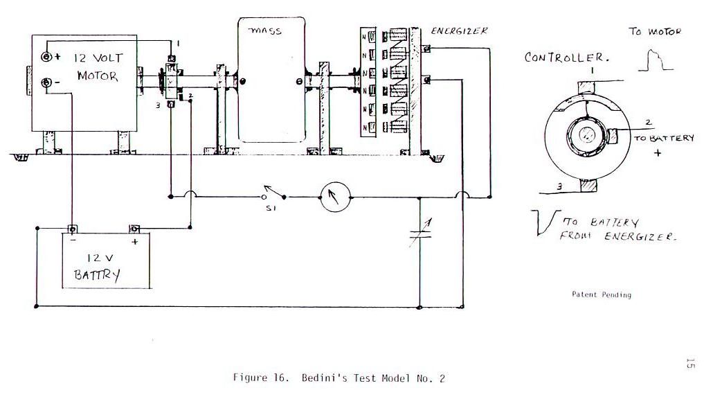

                Hi all, and here is bedini's drawing, showing that it is using a capacitor dump of probably a decent voltage, same as Jim Watson's device and more than likely, what Joel Legace is possibly demonstrating.
                peace love light
