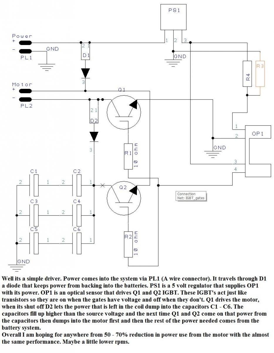

    Thanks Matt for starting a new thread. Where we over lap here is my use of your fly back scheme.

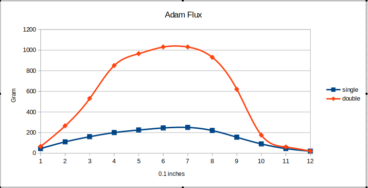

    Now what ties our motors together is the use of both poles. I have run into this before, Tinman, Bedini et al, So I did a test mock up using both poles and the only secret is it must have a flux return path. It is sort of counter intuitive one pole so much attract in --- two pole twice as much pull in, right? Well not so there is four times as much pull in.I am not sure where you triggered yours but I have stuck to the Adam's principle and the main driving force is the attract in, then at TDC the coil is fired with just enough strength to let the core depart from the magnet unhindered. Thus the trigger pulse must be long enough to stay on until the core is away from the magnet and not suffer and pull back from a too short trigger pulse.
    Here is a dramatic graph showing the four time gain. The blue trace is just a single magnet, the red is both poles in a complete flux loop.

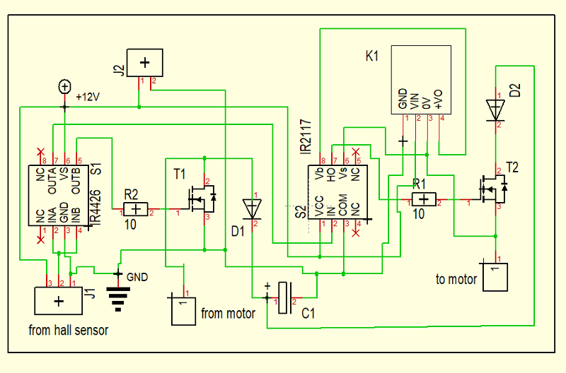

        To change the pulse length I can change the trigger magnet size. What I have in this version is a 23 ohm coil running on 48 volts. There is a good healthy fly back and the 1600 mfd cap will count up to 200, 300 volts very quickly. So I have tried various schemes and yours wins hands down. I see you show two P channel fets. I have tried a N channel in the low side and a P channel in the high side but P channel fets and I don't get along that well so have reverted to both N channel mos fets. Other than blowing up a bunch of stuff, when I did get to days show on the road it performed quite well. Here is a repeat of your jpg for this thread:
Name:	Matt_flyback addition to inp supply.jpg

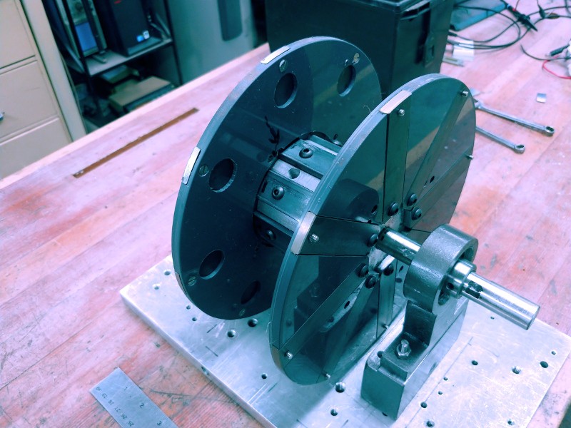

        Here is a pic showing the closed flux path, it is like a 'U':

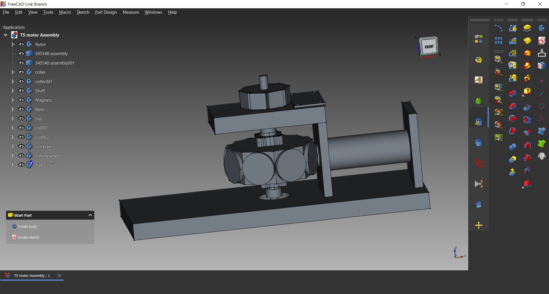

ID:	511677 I have the design for the TS motor all done in Freecad. I have all the calculations ready and I have all the parts, except for polycarbonate that needs to be milled, ready. The pic of the design is half ready. That only cause I need so much for milling.
                    It will be running next month. We'll see how it does.

                        Have to ask what the core of the rotor is made of? Aluminum? If so, could that cause a reverse magnetic pole in the center? Just a thought. Nice rotor tho. Thinking of doing a PETG 3D printed rotor to play with. Have some half inch by 1/4 inch iron flat bar for the U. Skate bearing inserts for now as not going to use shaft for anything.

                          I am curious, why would you put an aluminum core in coil that you need to make a magnetic field to push a magnet away. Aluminum wouldn't do that. Help me out...
                          Matt
                          • #14
                            No Matt, he said 'core of rotor' and yes the core is aluminum. Bedini made his rotors of aluminum is why I felt it was safe to do so.
                            The shaft is nonmagnetic SS though.
                            Ron
