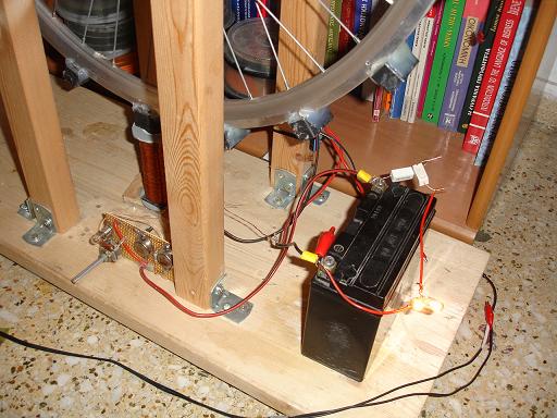

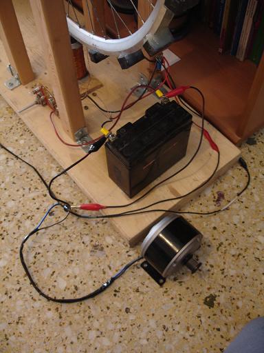

      I am gonna perform a simple experiment. i have two identical batteries. One i am gonna pulse charged it with my SSG till full (actually i am cycling it as we speak), and the second being "hot charged" and i am gonna connect it to my PMDC motor freewheeling consuming some 0.8amps (hence inductive load). I am going to notice if there is any appreciable differerence at duration times.
      Yesterday I completed one round of an scheduled experiment so as to see if there is any difference between normal charged batteries and those being charged by the inductive collapse mounted on an SSG made more or less by Bedini Specs.
      (mine has two transistors and two parallel windings instead one winding the simple SSG has)
      In the experiment conducted i used the very same battery. (Yuasha 10 nominal Ah, sealed type)
      After conditioing it for 8 cyles non-stop (each cycle is a day of charging accumulating some 3-3.5 aH and each night using a bulb to discharge it -night lamp actually , I hooked up my PMDC motor or the inductive load.
      The 1st experiment
      begun with a fully charged battery that is has a standing voltage of 14,3 volt sitting on SSG after thoroughly charged.
      Start-time: 15:30
      end time: 22:30 lasted 7 hours and end voltage was 10.90 volts (empty battery) Motor consumed 0.63 amps at first hours and then dropped 0.61 last hours. Average 0.62 amps.
      Calculated 4.34 aH of battery.
      The 2nd experiment
      Begun at cycle n. 15+. I wanted to have fully recovered the battery from the previous experiment. all same conditions were met. (14,2 starting voltage, same cycling method etc)
      Two 12volts bulbs were selected and further balanced with two resistors. Anyway consumption was a little hgher than the idling motor.
      Start time: 10:45
      End time: 18:15 end voltage 10,20 volts
      Primary bulb consumption was 0.68 amps first hours and fell to 0.66 later.
      I calculate a 7 1/4 aH of battery.
      Conclusion
      My first coclusion is that there is not any significant difference by pulse charging a battery using the inductive collapse method as it considered this method is suitable for resistive loads, whereas not for inductive loads.
      Minor deviations were observed but if we take in mind the cycling (thus super charging it) and voltage not completely identical levels, the above conclusion will be my case and I invalidate any theory regarding hot and cold electricity.
      Of course, someone could tell that the DMM records a current going to the motor, yet the motor does not produces same energy as the current going in! Then, in case someone claims that more sophisticated methods of energy metering etc should be enforced.
      ANyway, i urge anyone with the tools to conduct similar experiments and report findings in order to clarify those issues once for all.
