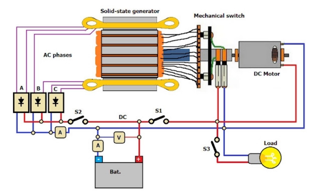

                          Here when current to battery is zero and three switches are closed (conducting), and load bulb is drawing power, remove the battery. If load bulb continues to shine continuously forever we have new world order.
                          Ain't gonna happen!
                          • #43
                            I do not recommend this, at least in this unstable installation. The battery acts as a voltage regulator in the DC circuit. If there is no current in the circuit with the battery, the battery does not charge or discharge, but it does a good job of regulating the lower voltage level. Professors joke with you by requiring you to exclude the battery, the formula for the current from the generator in a DC circuit is as follows:
                            I = (Egen - Ubat) / (R + r)
                            Where: Egen - Alternator phase EMF at idle speed; Ubat - voltage across the terminals of a battery connected to a DC circuit; (R + r) - load and generator phase impedances, respectively.
                            Even if the battery is excluded from the current components in a DC circuit, it fulfils an important role while remaining charged.
                            Failure to have this ballast at phase underpower will cause your system to lose the unreduced DC circuit voltage level, resulting in system zeroing.Be careful not to give in to tricky demands.Maintaining the operating voltage in the DC circuit can be accomplished through a capacitor.The approximate formula calculation is:

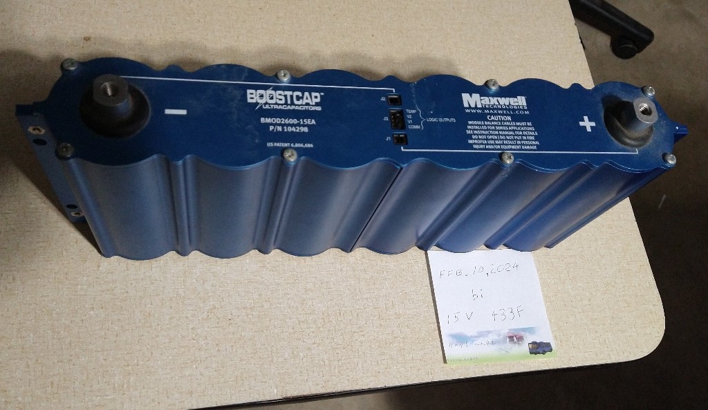

                              Hi Rakarskiy,
                              I just happened to have a suitable capacitor.
                              Click image for larger version  Name:	IMG_20240210_132652391.jpg Views:	0 Size:	156.9 KB ID:	513354
                              So you say to put this in place of the battery in your circuit, it will run continuously forever (many years) powering the load bulb at 130 W without any input?
                              It can not.
                              Ultra capacitor modules like I display (rated at 15V, 433F) are not too expensive and available. It is possible to procure, so prove your claim. Change the world order.
