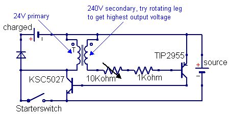

    This is my attempt to combine idea of:
    - radiant triggered transistor
    - work on any voltage
    The video:
    YouTube - Joule thief triggered with radiant secondary
    The result:
    - input current will reduce on load.
    - potentiometer can be used to tune the circuit
    - the circuit do not work with switching power supply as source, a very big drawback for me.
    Edit: It's working now, don't know what cause previous problem.
    - more efficient than my pnp npn 555 circuit. Previous has 0.7A at 10.5V input with 0.4A at 2.7V output, this can be tuned to 0.12A at 9V input with 0.12A at 2.7V output (input voltage is an estimation).
    - need bypass switch to start
    - inversing secondary leg may increase or reduce output voltage. Always try with coil without common terminal (no car coil / flyback transformer), but you are free to try.
    - using 15K base resistance, 12V source battery , 2.8V charged battery, output current is 100mA. Circuit will not work without load, will not work if amp meter is used to measure input current. The input current should be around 100mA based from initial experiment.
    - charge two 1000mAh nicad in series in one half hour with 100mA output current. charge is real, light up 3V bulb more than an hour.

        interesting circuit you have here. Just studying the circuit diagram, it looks like when the pnp fires there would be a temporary short in the circuit of the primary battery. have you thought about trying to power a load betweeen the collector of the pnp and the base of the npn to utilize that power or use resistance there to at least limit the current to the base of the npn. This same issue plagues the full sequential bipolar circuit that is used in the bedini window motors.

          Is it really necessary?
          Since the output of the PNP can be limited with resistor, it will also automatically limit the output of the NPN if we use high resistor value for the PNP. My current circuit draw 150mA charging two nicad using around 8K ohm PNP resistor. I can not go lower since it would shut off the oscillation.
          Edit, exact number is : 140mA at 9.8V input, 90mA at 3.08V output when charging two "AA" alkaline battery. Coil will draw 1 amp if transistor is by passed.
          I found that using two transistor this way is more efficient. This circuit is at least 4 times more efficient than 555 driven 3055, twice more than 555 driven 2955 driven 3055.

            I guess I should rephrase my question. Since the npn is switched at a loss from the input source, how much of the current draw is being used to switch the npn transistor? Knowing this will give me more of an idea on the efficiency of the coil at converting primary current to charge current.
              I try to measure current from source positive to PNP collector, at 10A setting in the amp meter, it read as zero. My other amp meter setting broke unfortunately so I can not measure it using lower range. During this test, PNP base resistor is around 8K ohm, input current 0.13A using 12V battery, output current 0.09A charging two zinc carbon. I hope this answer your question.
              Edit: using analog meter the current going to PNP collector is about 4mA.
              I am thinking that if I use 110V to trigger the PNP, it would require less current and it would also trigger faster. By using this to trigger the NPN, I would get faster switching.

                  Doing another replication which turn out to be more efficient. Using 9V/240V 2Amp transformer, same circuit with different NPN, with 60mA at 12V input can charge 2.9V at 80mA. While with 250mA at 10.5V input can charge 12V at 65mA. This much much more efficient compare to previous circuit where to charge 12V at 65mA may require more than 1 Amp.
