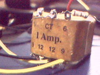

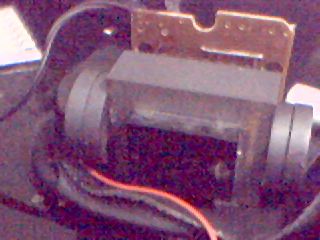

            What is the resistance of the coil you are using? could you upload a clear photo of the coil?
              Around 8 ohm. See attachment.
                8 ohms is quite high, though it is hard to tell what kind of inductance that coil will have.
