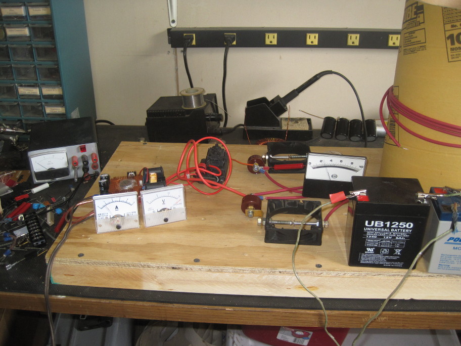

            Good idea, I can't think of any reason that won't work. Even without an external multiplier I think there is an internal multiplier within the flyback, probably 2 or 3 stages since it has the "focus" output coming from the first stage. Driven hard enough with a higher voltage input this should reach respectable voltages. I measured 13KV with 12V input, it should be more or less linear with voltage I would think (unloaded). So ramping it up to 24V nominal should be getting close to 30KV. Hopefully this is enough to start getting some more impressive results. Those ZVS/flyback units are plentiful and cheap, I already ordered a spare in case I fry this one.
            • OK, I tried the ZVS with two batteries on the workbench. No antenna or ground connections so essentially no load other than a small amount of leakage current. Sure enough, everything is roughly doubled: dipole voltage now 26KV, input current now 800 mA at 24V nominal (probably about 25V or 26V true). The whole machine crackles with static like a charged CRT, and the PPV's fire every couple of seconds due to just the small leakage current from uninsulated parts. It's possible this might be enough to be useful, I will test it with the antenna and ground after dark.
