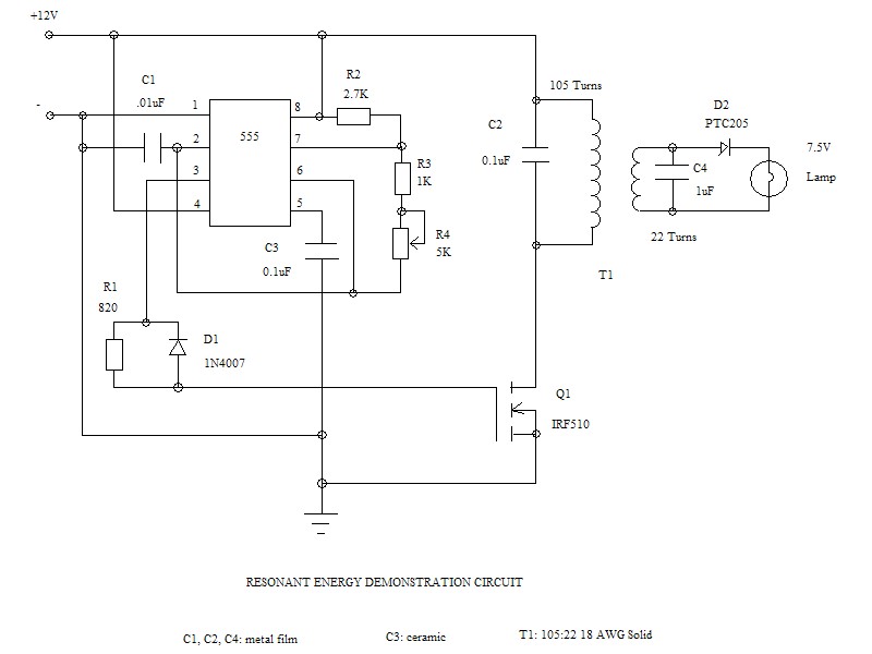

    Yes, I did some measurements of voltage and current at the input and the output, and calculated the power input and output. The meter I was using is an ordinary digital multimeter, so the AC readings are not accurate, since the frequency was about 40 KHz. Still, these readings give some indication of what was taking place. The device was powered by a 12 volt lead acid gel cell battery of 5 ampere hour capacity.
    Input voltages were measured across the resonant tank circuit composed of the L1 coil and the 0.1 uF capacitor. The output voltage was measured across the load.

    As shown above, the input power requirement generally becomes less as more lamps are added to the output, yet the circuit is able to run the lamps. The lamps were miniature 7.5 volt types.
    I tuned the circuit just by changing a small trimmer potentiometer used with the 555 circuit. The 555 was driving an IRF510 power MOSFET. The input tank circuit was connected to the 12 volts, and the drain of the MOSFET. The tuning is done only one time by watching for maximum brightness of the lamp or lamps. Then you can connect additional lamps and even a small DC motor.
    I would like to upload pictures, but when I tried to do that it said it needed a website where it can get the pictures. I need more information on how to upload pictures from my hard disk to the forum.
    Thanks.

      Hi WorkShopelf,
      Thank you for the information.You should be able to upload pictures to this forum via your account.When replying, scroll down to additional options.You will see manage attachments.Click on it and a dialog box will appear.
      Hope that helps.
      Any plans to do further experimentation?
      Ged

            • Hi Ged and all. I noticed upon checking the frequency with my meter that my driver circuit was putting out about 14 Khz, rather than 40 Khz when it was not connected to the air-core transformer. Originally, it would show a reading of about 46 Khz when using only one lead for testing the frequency of the input tank circuit.
                Thank you for the update.Very pleased with your experiments and observations.
                Your driver may be essentially kicking the tank circuit to oscillate at higher frequencies.Don's schematic had a similar spin.
                Did you calculate the capacitor needed for L1 and L2 tank (measuring inductances etc)circuits?
                Or as you have stated, you just tuned to brightest light you could get? Or both?
