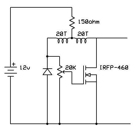

    • Now I have a bunch of IRFP-460s.
      I'll try tonight with with a selfmade aircore coil to see if high frequency makes any difference.
      How many turns would be minimum with an aircored coil?
      Say it would operate at 1MHz?
      Would 20turns 1mm enameled copper wire wound on 12mm work?
      • It works
        I wound 20+20turns 0.5mm enalmed copper wire on a standard AA-battery and slided the battery out.
        It runs at 200KHz and the output is 40V on a 12V@38mA supply.

          Hi Janost ,
          An excellent and really quick set up with good results. Its experimenters like yourself that keeps me going.Wow! May I ask:
          What frequency are you driving it at? Duty cycle? Are you gonna build a receiver or better yet receiver coils with the same specs rectify the output and see if with proper tuning we can get more out than in from the source? You say 40 volts out so far, what the output amps? Are you using a function generator?
          What if you had ,say, over sixty turns? What if it was wound bifilar? Like on both transmitter and receiver? Don't know if u have the time to investigate, but you seem to be the only one hot on this one just now.I have seen wireless transmittion experiments on youtube, even one with multiple receivers.Unfortunately no one checked output from the tuned resonant receivers.Like this guy here:
          Wireless energy transfer - Wireless powered LEDs - YouTube Wish he had properly tuned,position,rectified and measured energy output on all the receivers at once.One day I hope to thoroughly explore this idea myself.
          Just a thought.

          • hi janost.the trace on your scope shots looks like a half rectified amplitude modulated,am radio signal,like a spiky version of a crystal radio signal amplified.i don't know much about scopes.are there two frequencies cycling there,about 1:12or13 cheers.
            • Originally posted by hotrod68r View Post
              My scope has a sampling frequency of 1MHz and it is the sum and differences between that and the 200KHz that shows up.

                  Its not driven.
                  It selfoscillates.
                  Its a mosfet-JT but with an aircore instead of ferrite or ironcore.
                    I measured 110mA into a full short.
                    But i guess there isnt much of volts then
                    I'm gonna charge a cap with it and then fire the cap into another coil.
