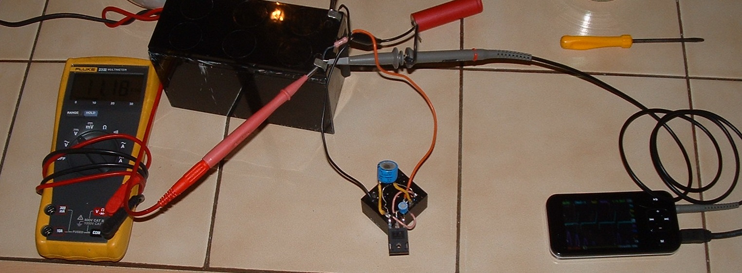

This is what was on the table in the picture.Originally posted by hotrod68r View Postcare to share your schematic yet? if you want a bit of time to optimize it first no worries.sounds promising.
There is 200VAC on the secondary but I'm not sure how to use it yet.
It also needs a careful adjustment of the pot to keep the current draw a minimum.
Hm, the 0.47F supercap is only 5.5v and the battery is now at 11.23v
Didn't think of that but it's still holding up.Last edited by janost; 03-06-2013, 12:04 AM.

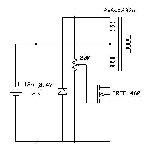

Hi janost,
Is there a mistake on the latest drawing you just posted? Is the wire going to the center tap supposed to be connected to the wire going to the top of the pot? That looks like it is shorting out one half of the primary windings. The earlier drawings did not show that connection.
Respectfully,
Carroll
PS: I guess you fixed it while I was writing the post. Sorry.Just because someone disagrees with you does NOT make them your enemy. We can disagree without attacking someone.
maybe a supercap is more receptive to the spike.i've got a half arsed theory that instantly on swich off isn't the best time to feed a pulse to a battery.maybe current has some sort of pseudo inertia or something within a battery.just a gut feeling more than anything else.power on.
SorryOriginally posted by citfta View PostHi janost,
Respectfully,
Carroll
I saw that and changed it.
It is supposed to pass the wire.

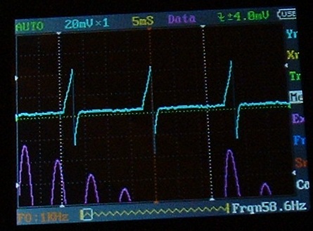

do your scope shots show a rest period?i'm under the impression there wouldn't be one.could be wrong.this circuit is my best so far for return v input with a transistor.i'll get a supercap and try it.maybe power off while your asleep

Yes, you are right.Originally posted by hotrod68r View Postdo your scope shots show a rest period?i'm under the impression there wouldn't be one.could be wrong.this circuit is my best so far for return v input with a transistor.i'll get a supercap and try it.maybe power off while your asleep
There isn't any rest between drain and charge current but there is a 15mS rest inbetween those events and the battery idles.
8:00 this morning the battery was at 11.24v
And when I disconnected the JT it jumped up to 11.43v
The Supercap due to it's ESR cannot deliver a current over 260mA.
But at 12v the mosfet-JT has a peak current of only 133mA in a 2.5mS pulse.Last edited by janost; 03-06-2013, 08:24 AM.
