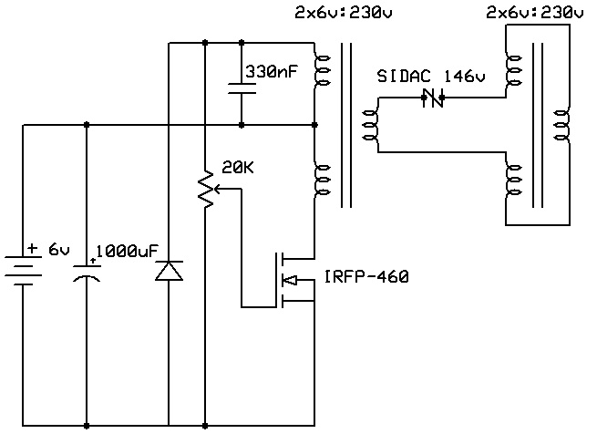

              • Originally posted by hotrod68r
                hi janost.this is my current setup.i thought it might improve the return with tuning.looks like there's a small gain there.would you have any suggestions to try.cheers.
                Have you tried it?

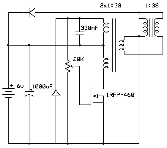

                • I thought of trying something like this.
                  It is the Kapanadze config on the secondary.
                  Perhaps adding a capacitor on the second transformer.
                  • I figured I try this config first.
                    The phaseshift between the primary and secondary is 90deg.
                    By wiring the primary and secondary in series and the primary backwards makes a total of 360deg phaseshift.
                    • ok.i'll try little caps on my coils.maybe try your sidac between the primary coils on your second trafo or across the secondary of it.maybe try shorting coil/s intermittently,maybe with a cap or two.so many maybe's
                      • Originally posted by hotrod68r View Post
                        When i short the secondary, the frequency skyrockets because the inductance of the primary drops.
                        • But I will try this on ferrite aswell.
                          The freq should be much higher making it more effective.

                          • Originally posted by janost View Post
                            Perhaps shorting it with a 50K trimmer?
                            And adjust it for optimal freq?

                              • hi janost.i was thinkin if you can match the sidac trip voltage to a coil that peaks at a slightly higher v ,shorting the coil right on the peak might be worth a try,but then chances are that there is a phase diff. between volts and amps.if amps ties in with field/flux strength then it is suggested that when the amps peak is the time to short the coil.maybe if you can get the power factor to 1 the timing will be right for a go.
