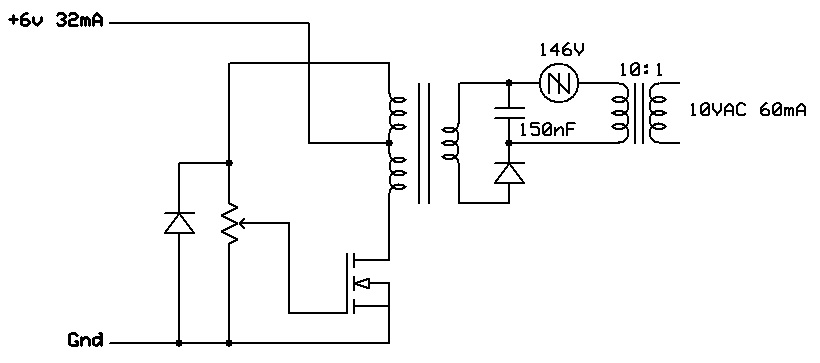

  • I got afraid of frying any more mosfets so I tried this.
    This is the Tesla way of discharging the cap into a coil.
    It works very well.
    There is only a singel discharge cycle every 50mS so the cap does not charge to 146v in a single cycle.
    But it still provided 60mA into a dead short.
    A 1nF - 15nF cap maybe

        Why the LEDs?
        Also, I cant run with a cap over the transistor because it increases the switching time.
        That is not good with mosfets as it increases heatdisapation and heat is lossy.

            The reverse B-E of -5V will never happen.
            Thats what the diode is for and the pulse is feed back to the battery.
            You should not have more than -0.7v on the base so only one of the leds should light up?
            My mosfet can take 500v drain-source and +-20v on the gate.
            What killed it was high pulses on the gate.

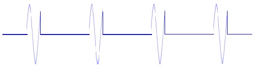

                    The output from the 10:1 stepdown transformer looked like this.
                    20V-pp and a repetitionsrate of 50mS (20Hz)
                    I figured that I first change to a smaller cap and then fullwave rectify the output.
