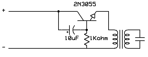

            • This is what I'll try tonight.
              Its a basic Colpitts osc.
              The capacitor is a bootstrap that pulls the base to the positive line for 10ms at power on.
              That makes the transistor turn on.
              When the transistor turns off because of the cap getting charged, the coil discharge and swings negative.
              A negative emitter in relation to the base at 0volt turns on the transistor again and the cycle repeats.
              Should work with minor adjustments to the resistor.
              Edit: This is why Kurt's darlington pair oscillated, the coil is biasing the emitter negative on the flyback.

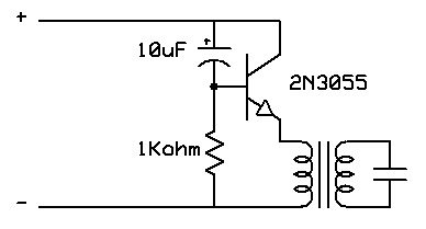

                • Drawn this way you see that it is actually a common base oscillator.
                  And you see how the coil feeds back to the B-E junction.
                  The capacitor has no other function than to jumpstart the oscillator like Kurt did with his finger.
                  As the coil is on its downward negative slope when the transistor pulls again there will be more than the supply voltage over the C-E junction.
                  This makes me belive that there will actually be a higher Vp-p over the coil than what is being feed from the supply.
                  I need to get this working if I'm going to make any high power 100KHz resonant coil as it needs to adjust it self to always stay on resonance.
