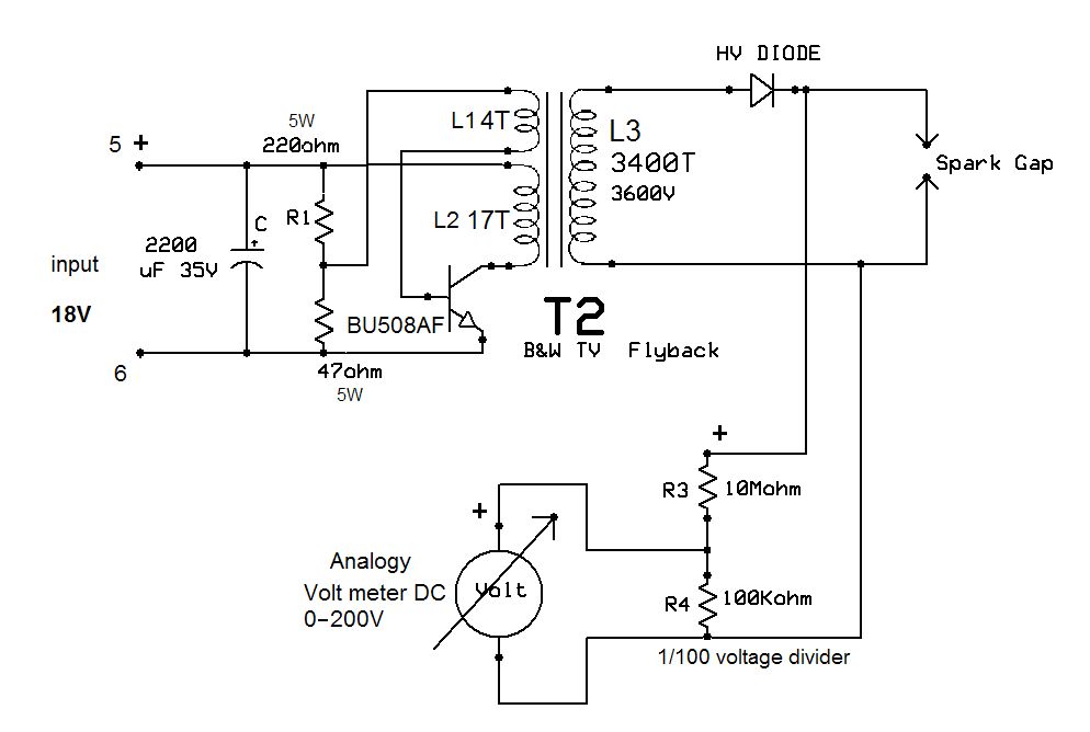

              • EDE Project
                Hi all
                thank you nutgone`s and all best
                ... continuing
                Stage 3: achieving HV and HF
                When we have a stable dc source, in the next stage we should step up the voltage to approximately 4000V and the frequency above 20KHz
                For driver circuit I use feedback, but I think it would be better to use ZVS /zero voltage switch/
                best for all balckrobi

                            OK, so my build goes on.
                            Today I did my HV module coil, as per Patrick Kelly's eBook, but I'm getting some funny results.
                            I'm powering my HV coil (8 turns pri + 4000 turns sec) via a 12v, 555 based, variable oscillator & a IRF9130 FET (as per Patrick Kelly's schematic, chapter 3 page 63).
                            So, why did I get a nasty shock from my variable resistors when I went to adjust the frequency???
                            My FET is also getting VERY hot, so I've gone for a bigger heat sink.
                            I can't do much more until my new LCR meter turns up & I can start getting some HV caps for resonance tuning. Here's what I have so far.....

                              • Originally posted by nutgone View Post
                                keep the cold end of ur hv coil earthed to prevent shocks!
