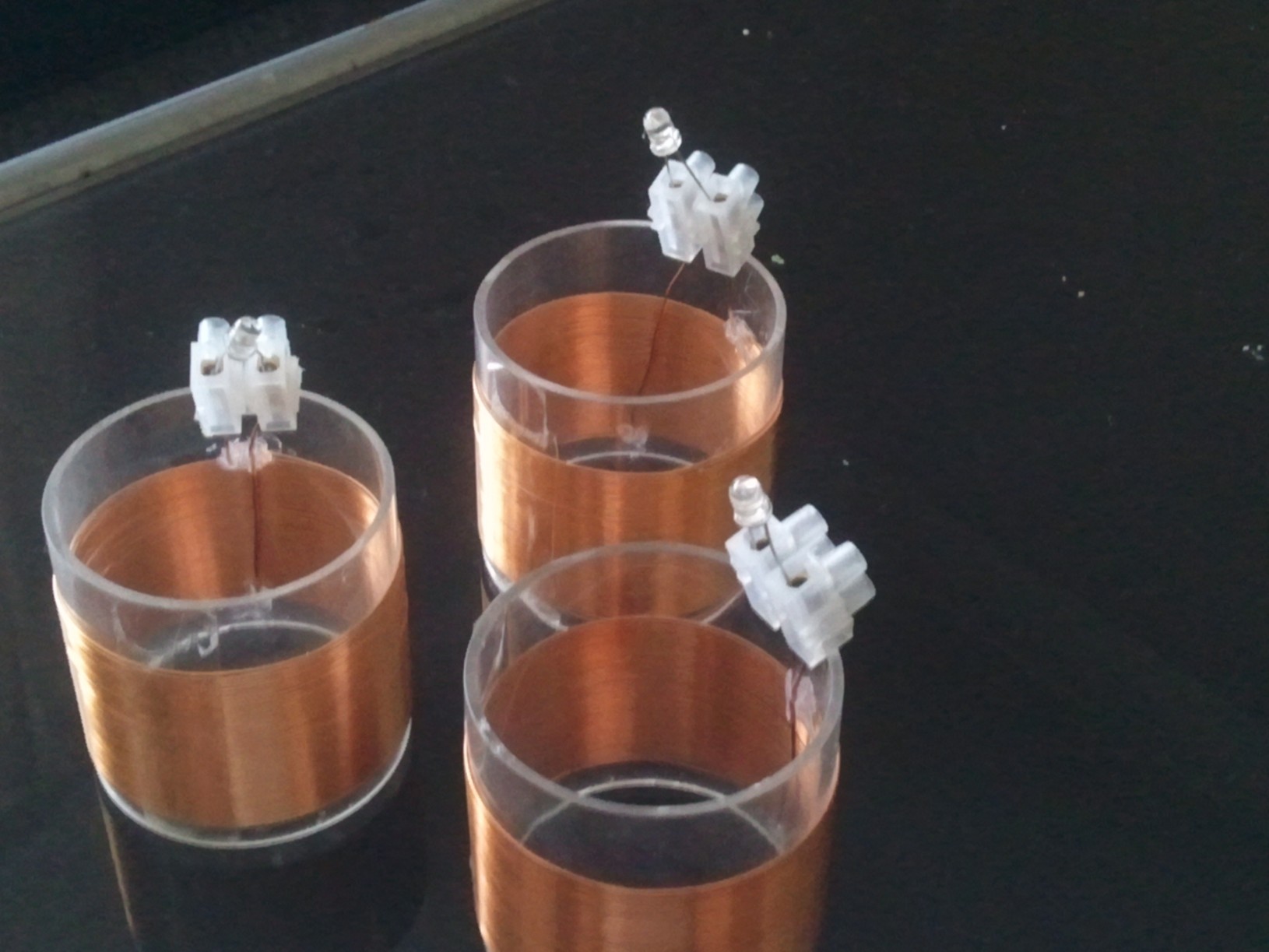

A few years back I made a replication of the science source project that Don talked about described in free-energy-info. 2 coils 60mm diameter, one with an LED the other hooked up to a function generator. I made about 6 identical coils in all and put them around the central transmitting coil - hubbard style. Varying the frequency you could tune it so they were all lit up. Sadly I had no way of measuring power in/out.
I also made a pancake coil on a cd and sat 3 recievers on top, with the pancake coil the LEDs lit up much brighter, got the best results with square wave. The higher the frequency the better too, signal generator maxxed out at 2Mhz.
I've since taken the coils apart for other stuff but managed to find 3 still intact, the pancake coil is around somewhere but i cant find it so just a picture of the receiver coils, but the pancake coil was the size of a cd and connected up like in tesla drawing. I did wonder about making a full size tesla coil with pancake primary and 3 secondary coils sat on top, unfortunatly dont get time for much building these days.
