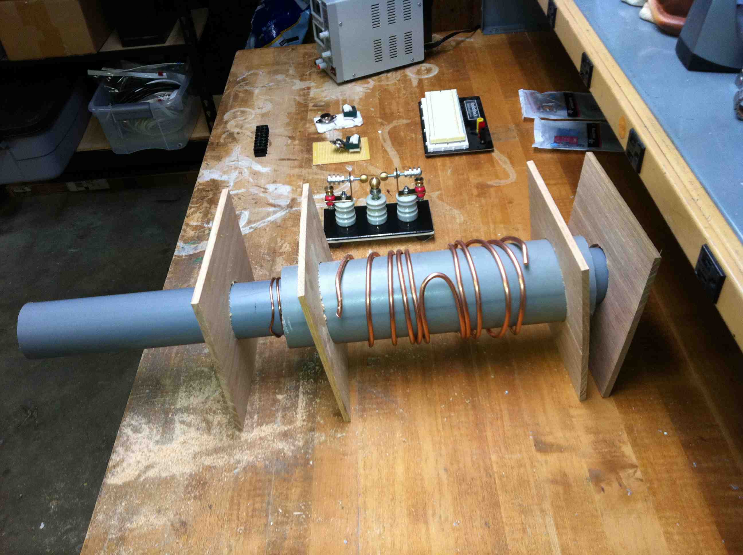

            • Construction Questions
              Taking one step at a time. From upstream to downstream.
              CUSTOM NST
              i do custom flyback for 4kV @ 35kHz. have two ferrite transformers (see pictures). identical specs for each:
              collector: 8 turns #24 approx 15uh
              feedback: 8 turns #30 approx 15uh
              output: 1350 turns #38 appro .5hy
              they are insulated for 6kv. the manufacturer says they are 4000 volt model at 15ma, 20kHz-100kHz operating frequency.
              going to run two in parallel from one or two 2n3055. any problems so far? They are 28k074 from this page... High Voltage Transformers
              Coils
              got 10AWG for L1 and 4AWG for L2 (step down). 10AWG is 0.2043 inches diameter. 10AWG is 0.1019, so roughly 2:1 ratio for thickness.
              winding is sloppy though. what do I use to space the wires? on the AWG4? on the AWG10? what do I use to fix the windings? electrical tape? epoxy?
              how do I tap these wires? make good connections? if L1 is length and L2 is length / 4, do I include leads / taps in the length calculation?
              What about wire spacing? Do I want to make L2 1/4 of L1 coil height too?
              Table
              my experiment bench has lots of metal underneath. Great big, thick wooden top, but all underneath is metal.
